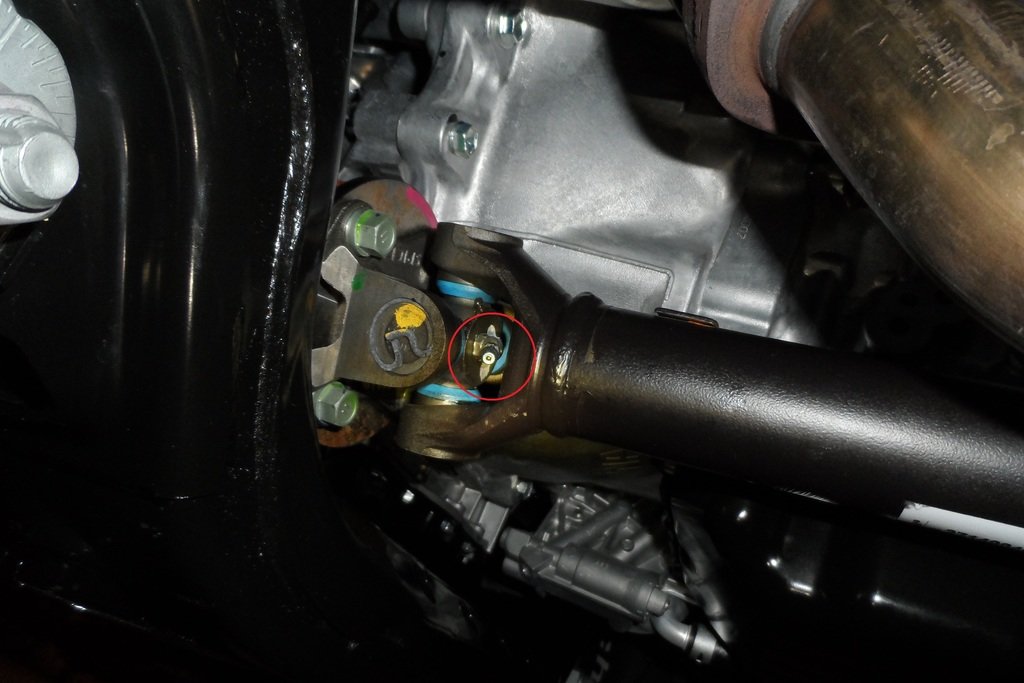

    I have made a mess of the very front zerk. This is the last one I tried. I even checked the ball with a pick to make sure it seats but if you say its possible that it isn't screwed in all the way I could check that later. The coupler fits on but the grease still comes out somewhere. I have had no problems with the others. Only the rear front, after removing the blast shield, seemed to have any grease prior to my work. Its cold and wet under there. Perhaps I'll try tomorrow.
    AZTacomaDreamin likes this.

    There's a relief cut in the yoke the zerk should be aimed at.
    I have to get my grease fitting right up against that. If my aim it is good it clicks right on.
    I find it helps to hold the driveshaft in one hand and the grease fitting in the other; you get more of a feel for it.
    Maybe your grease fitting is too big; you can try grinding it down on one side like another member did.

    Turns out the zerk wasn't fully screwed in as Slipstream87 said. I used the ol' 3/8 to tighten so it was pointing straight down the middle, like a McManus field goal. Grease applied. Thanks everyone.
    GO BRONCOS!

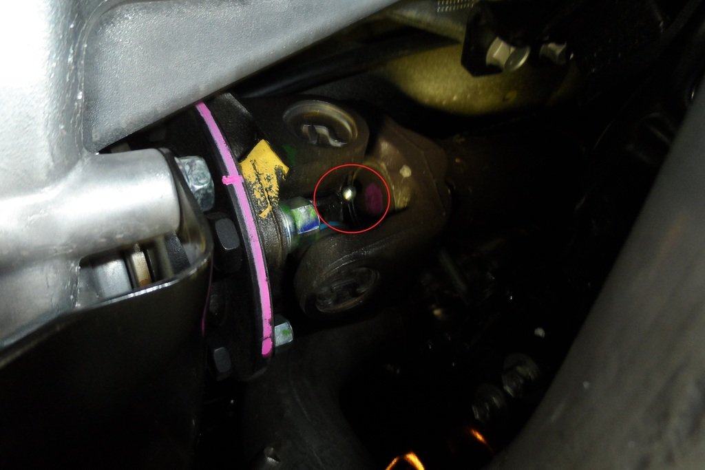

    So my 2016 TRD OR double cab short bed 4x4 only had zerks on the rear 3 Joints. The front 2 didn't have zerks... But you all seem to have 5.. Can someone explain why this is?
    Also, I greased the 3 rear Joints, but one of the joints only oozed out of one of the 4 arms, the other 3 arms didn't ooze out anything. What should I do? My truck only has 70 miles on it. The other 2 Joints purged normally and oozed out all 4 sides with about 5-6 pumps. Thanks!

    Was it the center one?
    You could also try driving it around a bit; that's what I did.
    Also, make sure you're not on an incline
    The fronts are there...hiding. You can rotate this shaft by hand, freely.

    Thanks!! I got the front two, didn't know they were hiding. It was actually the last U-joint on the back, by the rear differential that was only clearing from one bearing seal. I will drive around and lube it on another day. Thanks again! Much appreciated!
