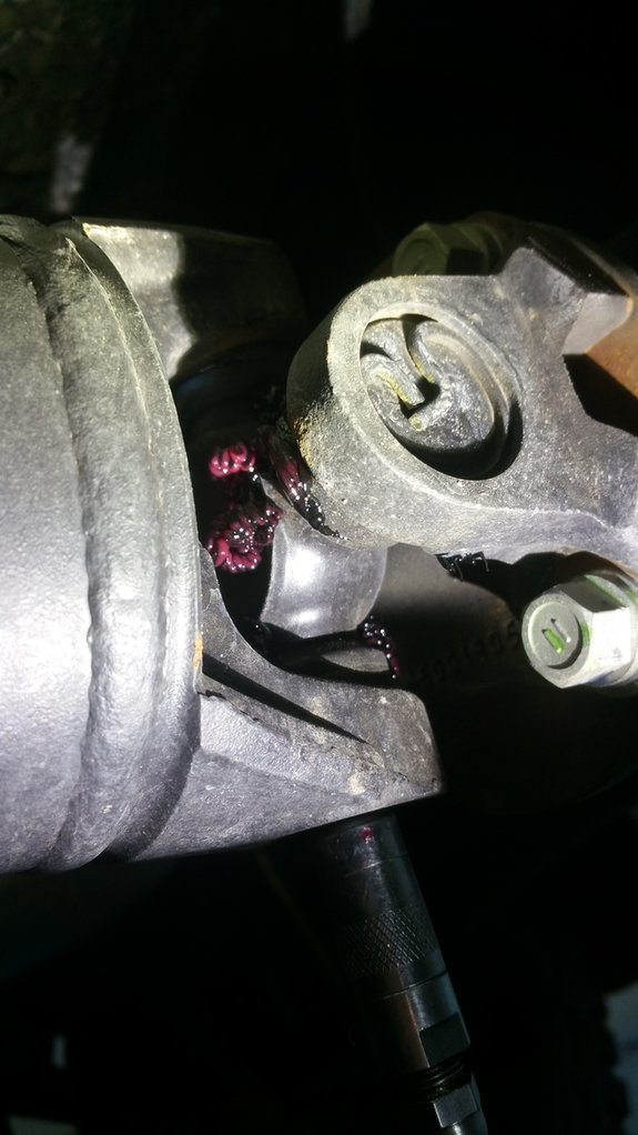

    Greased my drive shafts all five zerks. There did not appear to be any grease inside them, grease pumped in easily a dozen or so pumps until resistance was met and grease started coming out where it was going in. I had a little bit of a shudder on hard launches that appears to be gone now. First time it was done since new and now at 49k miles I wish I had done it sooner, like at every oil change...

    I greased mine today, well 3 of the 5, I didn't have time to remove the shield to get to the front two, but I'll do that tomorrow. So my shaft is only partially greased.
    For the ones I did grease, 8 to 9 slow pumps and finally a purge. Truck feels a lot better now.

    Greased mine yesterday. They took between 3 and 5 pumps before purging. Rear shaft joints purged regular (dark) colored grease, fronts purged red grease.

    My truck is a 2015 with ~7,000 miles and they were pretty much bone dry. What little grease that purged out was jet black and smelled horrible. Glad I checked.

    thanks for the heads up, did all mine. Front two were bone dry, rear three needed 3-5 pumps in each.

    I greased mine at 800 miles. It now has about 2800 but decided to check them while it was on the rack. All 5 took several pump

    750mi on mine. Checked them this evening after reading this thread. All of them needed 5 to 7 pumps with the grease gun.

    Did mine today. About 3 pumps for the first 4, but the one on the rear end took about 6. Thanks again to the OP for keeping our trucks running smooth.

    Got this done this morning, and I appreciate the help from OP. 4-6 pumps each.

    I did mine on Saturday. Only 255 miles on the truck; all 5 took three pumps. I managed to get the fitting on the one that was challenging without pulling the shield. I will check them again at about 1K miles then every 5K. It is nice to have greaseable u-joints IMHO, I do not really care for the sealed units. I also noticed that these do not use the nylon injected "rings" (not sure the proper term, but I hated changing them out) to hold them in like GM does (and maybe others). This is my first Toyota so this is likely not news to others on here.
    On the upside my u-bolts were torqued to >75ft-lb so all is good there.
