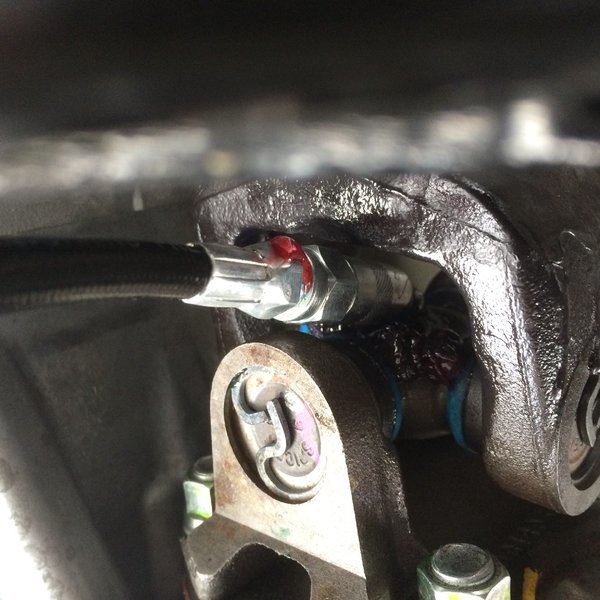

    Well the shit show continues. I guess asking the dealer to change the zerk and purge the joint translates to "nah, I'll write customer says just to check it and make sure it's lubed" I just pulled the heat shield off, guess what? Same zerk, not purged. About to try this myself one more time. image.jpg image.jpg On the bright side, I guess my ATF levels are fine...so they say.

    Sure looks like a needle should get that. If it were mine I would take a die grinder to the yoke, so from now on I could use just the coupler. I have done this many times before on other equip. with no problem.

    Agreed! I have just now went one step further this time and removed the shield and the bracket from the frame. The bracket is 12mm x2 bolts and it seems my access may now be even better. Bought a different coupler so wish me luck, here we go.

    Yes sir, a needle will definitely fit. I'm on my own again or I would try the needle with a second pair of hands as you recommended. Using the first needle (albeit the "cheap" needle) was a real bear for me. I went to Oreillys but they didn't have the Lincoln so being as I ground down my last coupler, I bought a new one which is a Lincoln. I'm about to try this again before I grind down the yoke. Thank you retired mech.

    I'd try loosening the zerk first; looks like it's pointed down in your photo.
    It also looks like something's fucky with the ball; so it might be the zerk itself and nothing to do with clearance.
    I'd pull and replace the zerk before I started grinding.

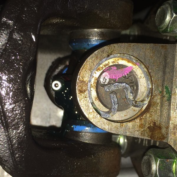

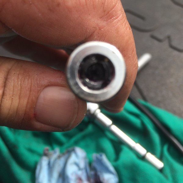

    Well that was easy! The only variable that changed this time was I used a Lincoln coupler. Looking inside at the old coupler, I notice now it has 4 "prongs" to grasp the zerk whereas the Lincoln only has three. I think it was the extra prong that wasn't allowing me to make a purchase on the zerk. The Lincoln seems to have allowed me to rotate the coupler slightly to where it slid right on. Many thanks to you SplitBolt and Retired Mech, I perservered and learned much from the process.
    Picture 1, old coupler.
    Picture 2, Lincoln coupler
