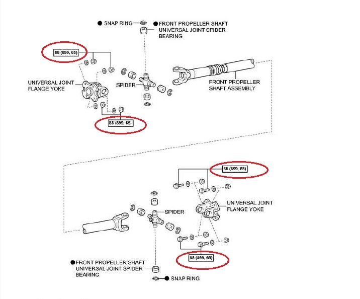

    Is there anything in the u joint that is worth checking for proper torque while in there?
    (today is monthly play with your torque wrench day)
  5. Apr 16, 2016 at 5:24 PM
    #685
    splitbolt
    splitbolt [OP] Voodoo Witch Doctor
    Mar 7, 2010
    #32761
    7,858
    NW Arkansas
    2016 TRD OFFROAD DCSB MGM
    Proppeller shaft bolts...
    Give me a bit; I'll post the illustration.

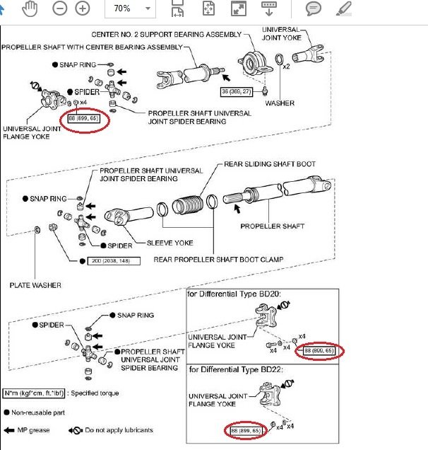

    Of the numbers in the rectangles, is that first number the lb/ft torque? I need to check my DS since they installed a new one. Can't remember which number is Nm and lb/ft.

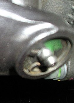

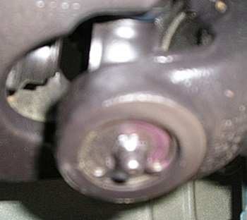

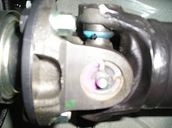

    Okay friends I was indeed hallucinating yesterday when I took a look at my U joints. I must of been having flash backs because I gave up drugs to many years ago to count and no chilly craft beer touched my lips ..... bummer. So I crawl under my SR5 4x4 Access Cab today and find the following.
    Zerk3_c3b3ea50805ff26c398aba5520c5fa4e025cbbeb.jpg Zerk1_058237ed94091c3dae7db347f6c8c6cc5659a157.jpg Zerk2_6e520e3a3aa87555d65d3366c154f48ca5aa45fd.jpg
    Funny thing is all I could see is one zerk fitting for each U joint as shown above. So the question I have is where are the other two zerks I guess I missing???
    Two pumps of grease in each to fill.
  17. Apr 17, 2016 at 3:10 PM
    #697
    Aussiek2000
    Aussiek2000 Well-Known Member
    Sep 5, 2015
    #163499
    5,652
    2016 Offroad AC
    Other 2 are on the front drive shaft. They are on the joint itself. May have to spin the shaft to see them

    There is a key in the bottom left, looks like it's the last number (65 in all of them).
    B.
    mello03[QUOTED] likes this.

    Yep I knew the key was on there I just didn't see it. Thanks!
