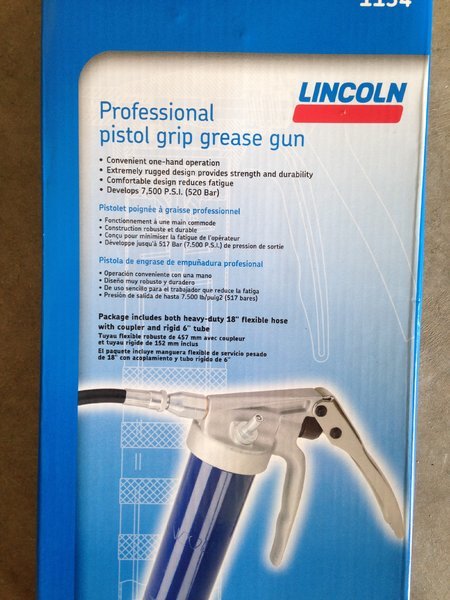

    Just finished all 5, bought a new gun with a flexible hose off Amazon, always looking for excuses to upgrade my tools :). The front were harder but by holding the hose on the zerk it was possible. The heat shield was two easy bolts to remove for the rear u-joint on the front shaft. Used the specified grease also. Thanks for the help TW Forum.

    How did you like that grease gun, just bought a new one myself, same model.

    Best one I have owned.
