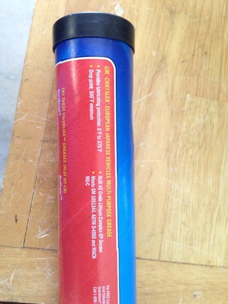

    Can anyone let me know if the following would work for these? I currently have : NLGI GC-LB lithium complex grease loaded in the grease gun.

    Should also say "#2" somewhere on there...
    Which grease is it, specifically?

    It's Sta-Plex extreme pressure premium red grease.

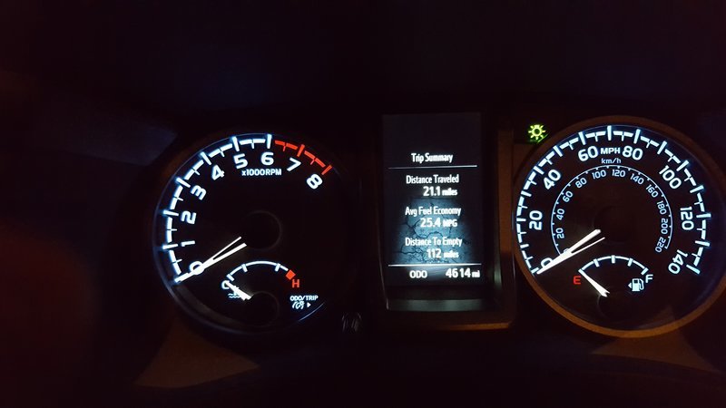

    image.jpg I thought the mpg's might be too good to be true; so I took an out and back drive mostly highway and got these results. Go get that grease gun:)

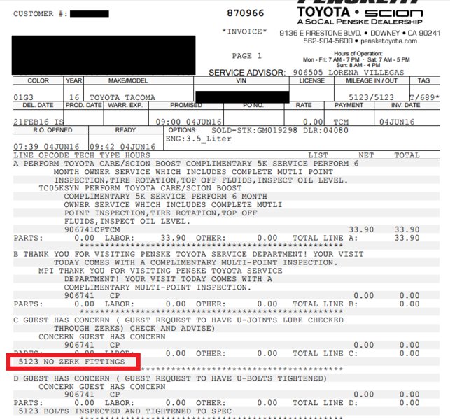

    Had my 5000 mile checkup today. Asked them to check u-joint grease and tighten u-bolts in addition to the multi-point inspection and fluid top-off. After 2 hours, my truck was ready and was informed that my model did not have Zerk fittings on the u-joints because it was new. Now, last week when I went in to have my tranny fluid checked, because of what I read in this forum, I was told they did check and attempt to top it off, but it overfilled right away, so it wasn't low. My confidence in information pulled from this forum wasn't that high, so I didn't argue with them. However, when I arrived home I just had to see for myself ... sure as shit, Zerk fittings on all u-joints.
    Lesson learned. If they pull stunts like this, how can I believe anything I'm told? I also doubt they really checked the transmission fluid or the U-bolts. Guess it's time to invest in some more tools and take maintenance into my own hands. Disappointed.
