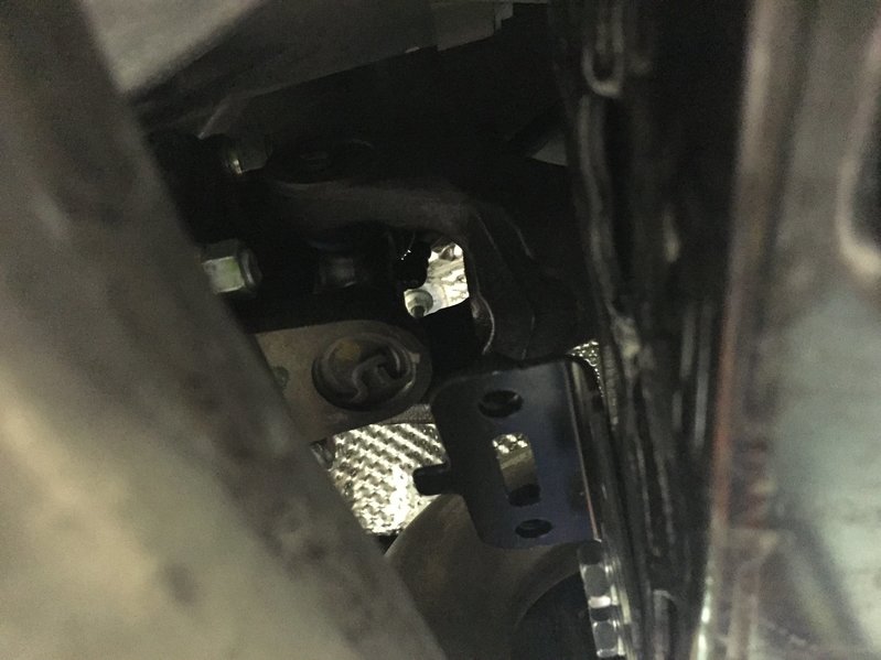

    I greased mine at 800 miles the first week I owned it with some nice waterproof grease. One of the joints was a real pain at the t-case. I can't remember if it was front or rear shaft

    Pic of the aforementioned joint after I removed heat shield

    Fitting wise, a standard off the shelf gun will work?
    And how much grease should purge?

    Regular grease gun with flexible hose. I just full them until some oozes out of the boot
