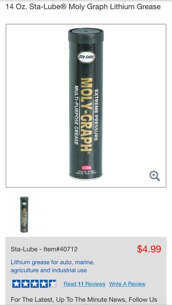

    Took care of my truck today. If you don't like to get dirty I recommend you get someone else to do it for you lol. And don't wear good clothes as this will mess them up. I used this grease. Hope it's ok. It said for u-joints. image.jpg
