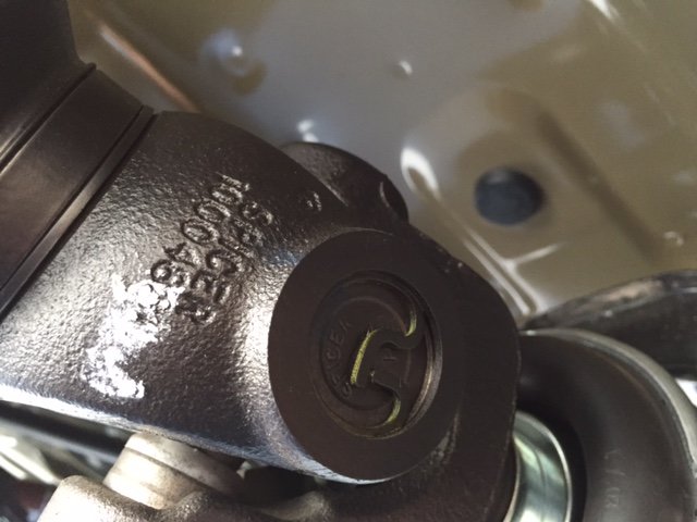

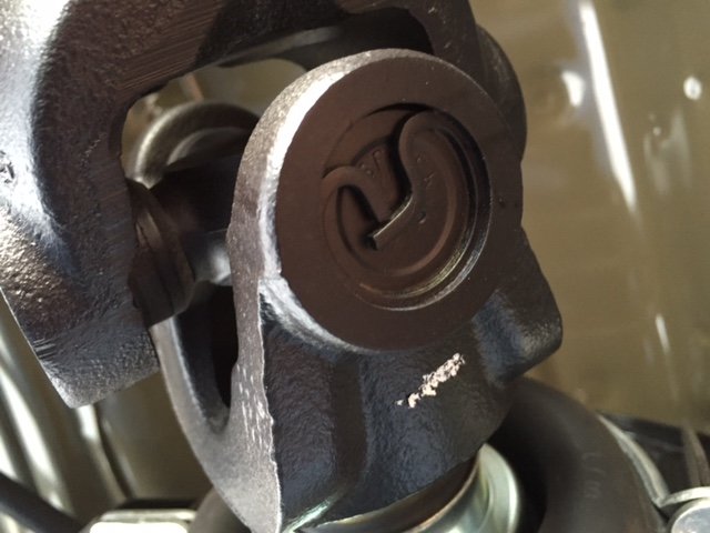

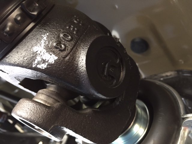

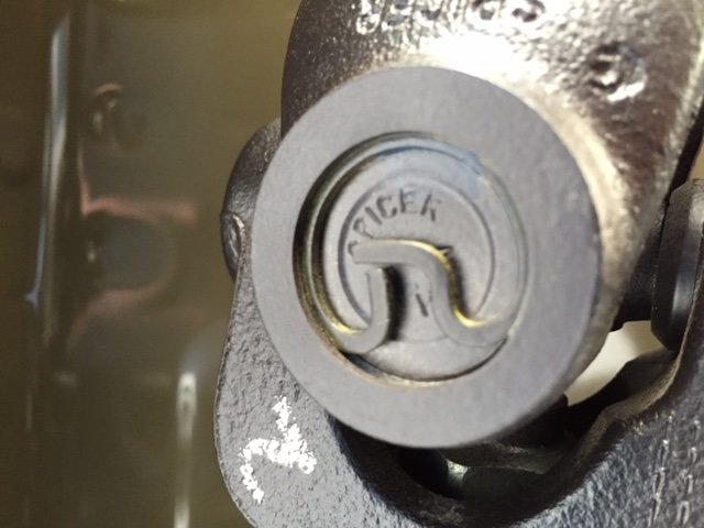

    I only have 2 zerk fittings on my DCSB 4x4 Sport that I can find. Built in July 16 in Mexico. I greased the two front zerks. The front-most zerk still had the black paint and took 8 pumps. The second zerk on the front drive shaft did not have paint and had a small amount of grease on the fitting. That zerk took 4 pumps.
    My rear drive shaft has no zerk fittings. Photos are attached (God willing) and I numbered each end cap at one of the u joints to show four different end caps without a fitting there. What am I doing wrong?IMG_6496.jpgIMG_6497.jpgIMG_6499.jpgIMG_6500.jpg

    The zerks might not be on the endcaps? did you look all around the ujoint?

    Looks like your seals are non-purgable; lack of blue plastic.
    Weird...
