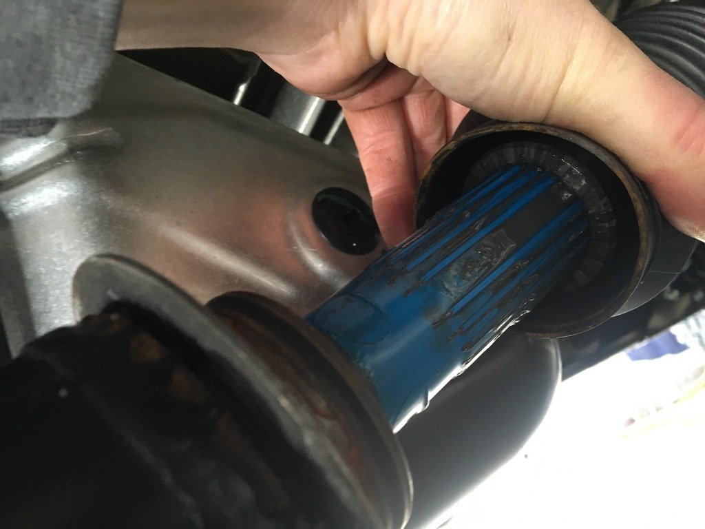

    i need to replace that boot you slid back some sticks and stuff shredded mine up from wheeling. any ideas where to get that from aside from the dealership who wants like $90 for it?
