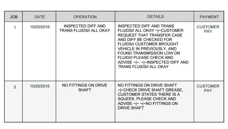

    Ran across this thread. Pulled service history from http://www.toyota.com/owners/ Can't wait to get home and check for zerks.
    Livermore Toyota:

    My dealer said they checked them. I call BS cuz after i greased mine, the black paint rubbed off the nipple when i took the hose from the gun off. Which tells me they didnt do it. I didnt see anything for the propeller or carrier bearing that rides on the rear driveshaft.
