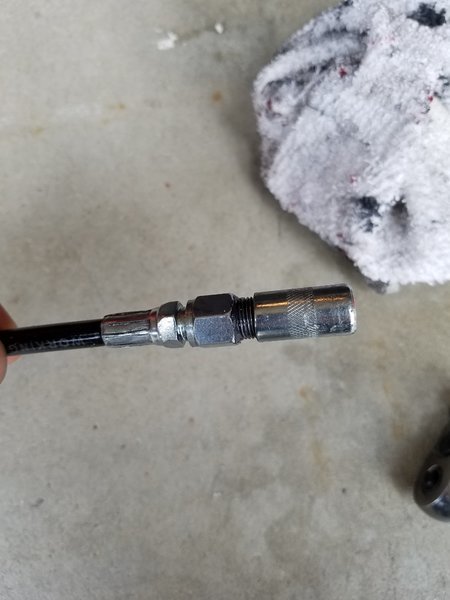

    Same scenario when I first used my flex tip screw end grease gun. Grease everywhere but into the zerk. On one piece of yard equipment I replaced all the zerk fittings blaming faulty frozen fittings when it was actually a faulty me. Glad you stuck with it. Even so many times getting the grease gun tip on and off can be difficult. Loosen the tip to put on zerk then tighten it to grease. Reverse to get off as this little procedure may make things easier. Works for me. Right or wrong. Dannyblues

    That was what l ended up doing, grinded some material off the tip and it gets in there easier.
