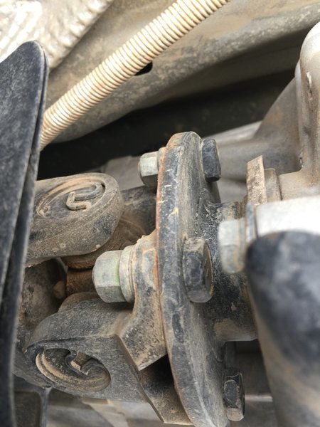

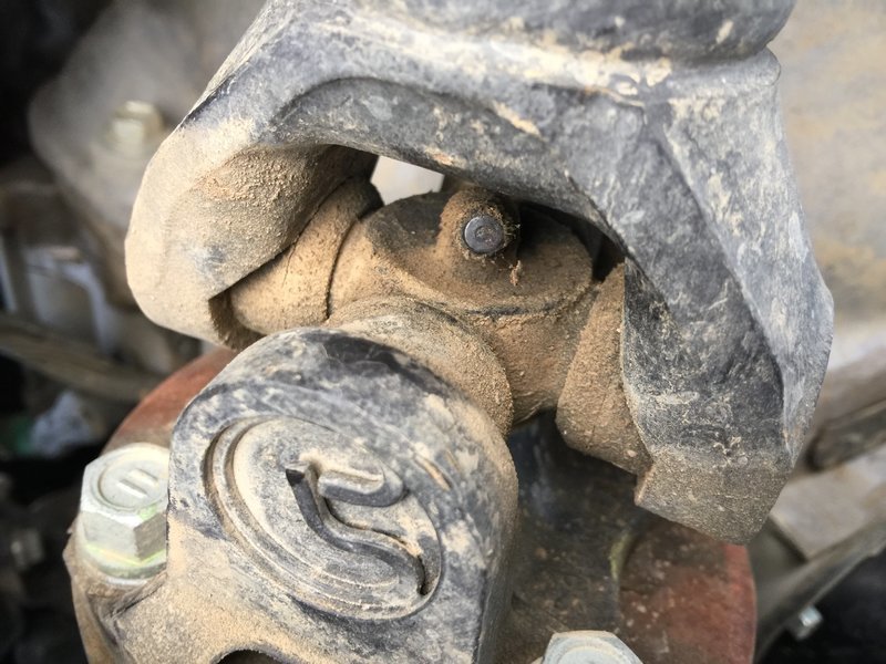

    Had my u joints lubed by dealer shop second time yesterday. Thanks to this thread I went to the dealer several months ago and told the foreman that my 4x4 2016 trd made in march 2016 probably had inferior lubrication as I learned here. I asked the dealer shop to check how many grease fittings I had and to properly grease them all.
    The foreman returned and said his mechanic found and greased three zerks and the other two were factory sealed.
    Yesterday I instructed the foreman to oversee his mechanic and to remove the front cover to access the two front zerks.
    As I thought! There are five grease fittings! Not three. And the front two were not sealed.
    I can only hope they actually did the grease job.
    I've become known at this dealership since I had to get Toyota USA corporation involved with the incompetent work done there. ( Here also I learned the simple fix to my manual transmission getting stuck in gear was a long well known posted TSB )
    After my marriage to Toyota expires for free service at 25,000 miles with Toyota care I think I'll find another Toyota shop or a good local shop to do services.
    BTW: the desk jockey at the counter at the dealership wasn't even aware and contested at first that propeller shaft lubrication! And the foreman told me that today's toyotas are so well made that such things as propeller shaft greasing and changing fluids in the differentials aren't even necessary ( unless your rear diff has a decal stating LSD, a real limited slip differential ) which I doubt mine does. On this site it was also explained to me that the LSD listed as a component in my Tacoma is simply an open differential that uses the ABS systems traction control to transfer power to the non high spinning wheel when for instance that one rear wheel is slipping on ice. A true LSD system employes clutches or some other method to allow both wheels to turn when one slips past 100 rpm more than the other more or less.
    Be aware of what you are entitled to and develop a relationship with your service tech or shop so you don't get ripped off or have improper services done!
