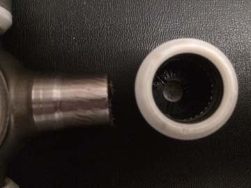

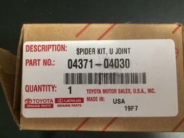

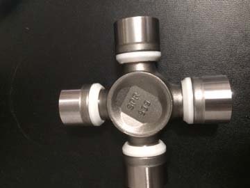

    I investigated the spider/u-joints used in the 2017s that have no zirc fittings, and have contacted Toyota about it (see attached images and part number). These u-joints according to Toyota and Spicer are lifetime units! I was a Marine tracked-vehicle, and Chevy truck mechanic in another life (I'm 68), and I don't buy it. While these units may last a long time, perhaps 100,000 miles, they may only last 20,000 miles. Spicer notes not to mix the cups. They are greased into the spider, so the units should last some time, but not forever. My dealer service manager had no idea that they were not serviceable, not surprisingly. I looked at the 2015 spiders, and according to my micrometer are a different diameter. They must have changed the configuration of the driveshafts in 2016. I'm looking for a replacement by the time I need to lube (ca. 5-10,000 miles). I'll post here if I get one. I've queried Spicer, but nothing yet. These spiders are $90.

    I never did like the " ZERKLESS " idea from the very start .
    They say the polypropelyne universal joints are sealed and prevent contamination because of the way they are designed .
    Manufactured for 50,000 trouble free miles ? ...50,000 is what manufacturers consider a lifetime .
    Will the sealed universal joints last through the warranty ? possibly and dependent on how the vehicle is used
    Every " sealed " universal joint I have replaced was rusted to the point where the 4 internal trunions were damaged and unrecognizable .
    As far as I am concerned , Toyota is making a mistake by removing the zerks .
    Keep the zerks on the universal joints , ball joints , tie rod ends etc and allow the owners to flush the contaminants out at the same time they change their engine oil
