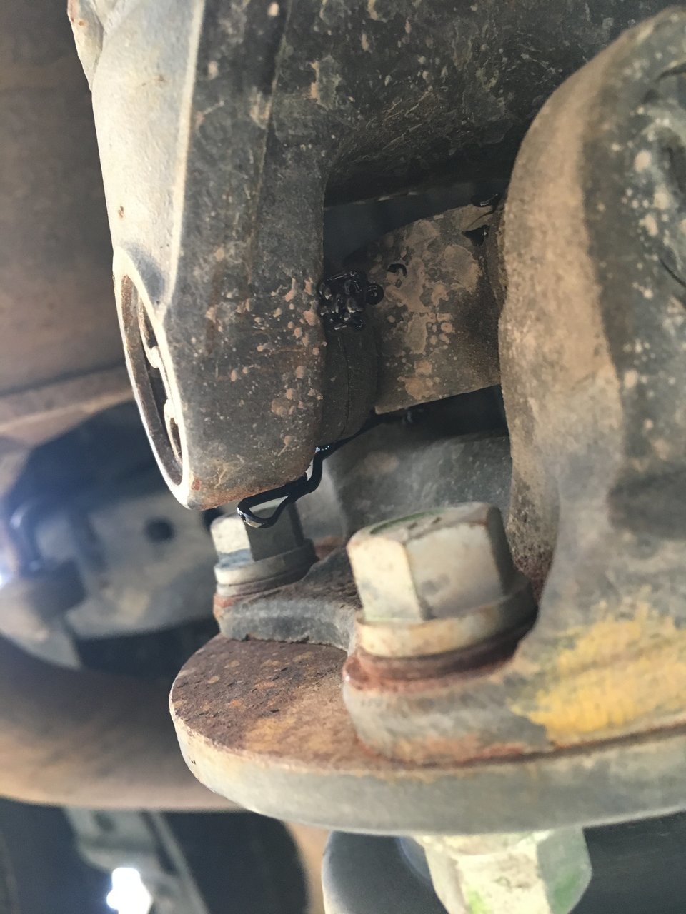

  19. Jan 8, 2018 at 7:37 AM
    #1259
    Edmonton Taco
    Edmonton Taco Member
    May 1, 2012
    #78039
    18
    Brock
    Saskatoon, Sk
    WHITE 2010 TRD SPORT DBL CAB
    I've been weaning myself off of the (st)ealership more and more. Yesterday I greased all 5 zerks on my Tacoma's drive shaft by myself (2010 TRD AUTO DBL Cab). I just made sure I used a NLGI No. 2 grease (picked up a cold-weather specific type, was -30 to -40 degrees Celsius for a good month and a half here) and a grease gun from the parts store. Put the truck up on jack stands (rear) with safety backup blocks and a spare tire under the frame too.
    I'm 6'3" with big hands and the front drive shaft is pretty god damn hard to get at without scraping your knuckles once or twice. For cleaning the old grease afterwards I found that bringing a small skinny flathead screwdriver worked best - I'd just sort of scrape and get a glob of the old stuff (that came out of the seals) stuck on the side of the screwdriver and most of it would stick and pull away leaving a minimal amount. Then I'd use one of those clean wipes (that come pre-soaped up with regular soap) and used the screwdriver to stuff it around inside and then I'd run it back and forth in a flossing manner. Then I'd clean up with a regular shop paper towel. That seemed to work.
    When I first got my Tacoma about 8 years ago I had undercoating applied to it. I noticed that the undercoating had basically covered all of the zerks too - and the dealerships I went to never cleaned that shit off of each zerk god dammit. So I cleaned each one off. The front drive shaft greased looked more wet as it came out, and a dark, oily and shiny black colour, and it took me about 6 or 7 pumps before any grease started to come out of the seals.
    Hoping with regular greasing that I can keep this thing running tip top for another 8 years and more!
    Looking at my brakes as the next learn-on-my-own project.
    Anyways, thanks to everyone that posts very helpful information on here, really helps clear up the mud. And thanks to those who post vids on youtube too that show how they've done their maintenance on their Tacos - really helps to know what tools and materials to have in advance so I don't have to get up and drive to the parts store over and over again.
    Happy trails.

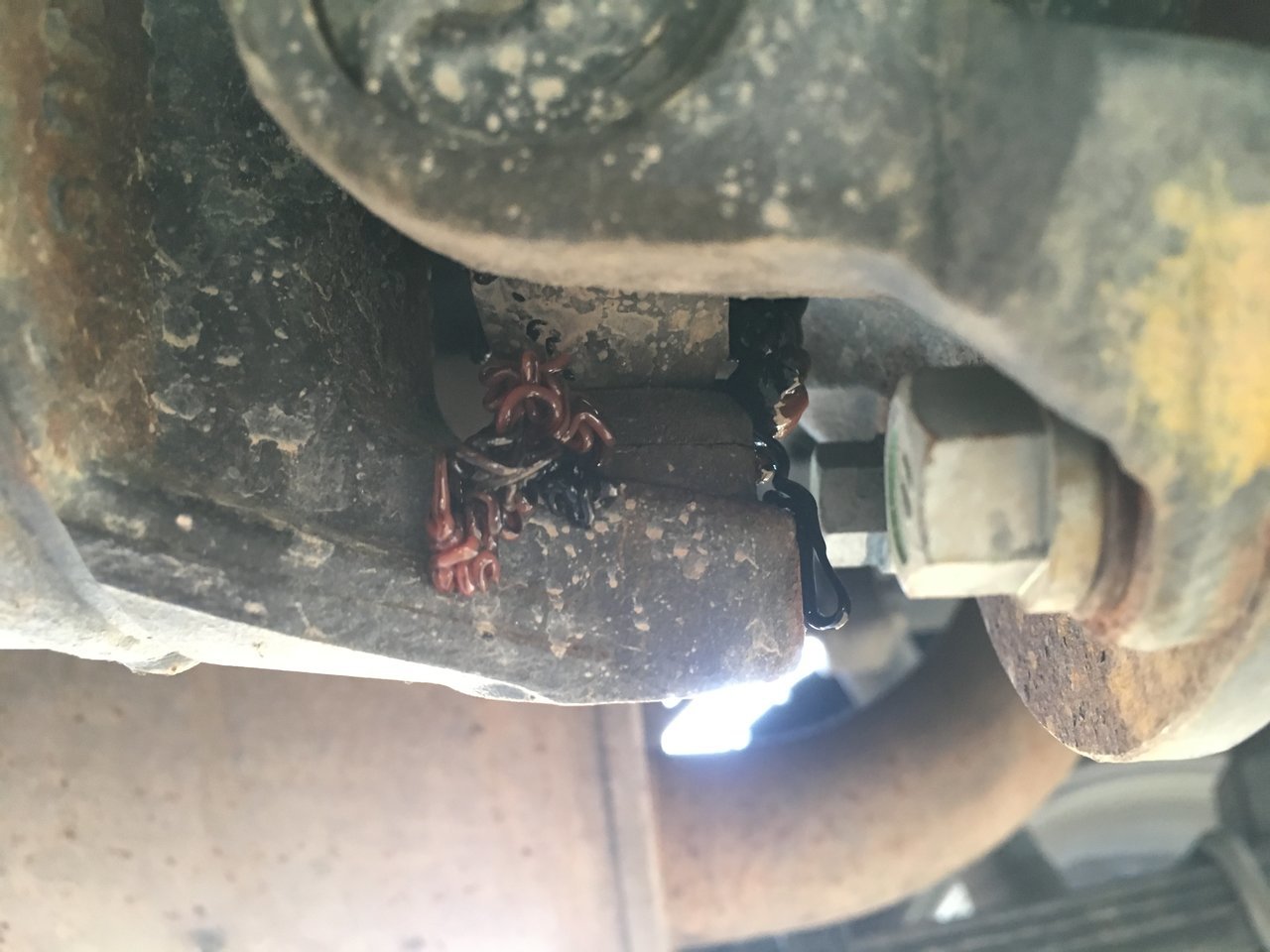

  20. Jan 8, 2018 at 11:10 AM
    #1260
    splitbolt
    splitbolt [OP] Voodoo Witch Doctor
    Mar 7, 2010
    #32761
    7,858
    NW Arkansas
    2016 TRD OFFROAD DCSB MGM
    I do something similar with a microfiber rag and piece of no. 12 solid wire.
    It slings enough grease as is; could just imagine what it would be like if I didn't.
