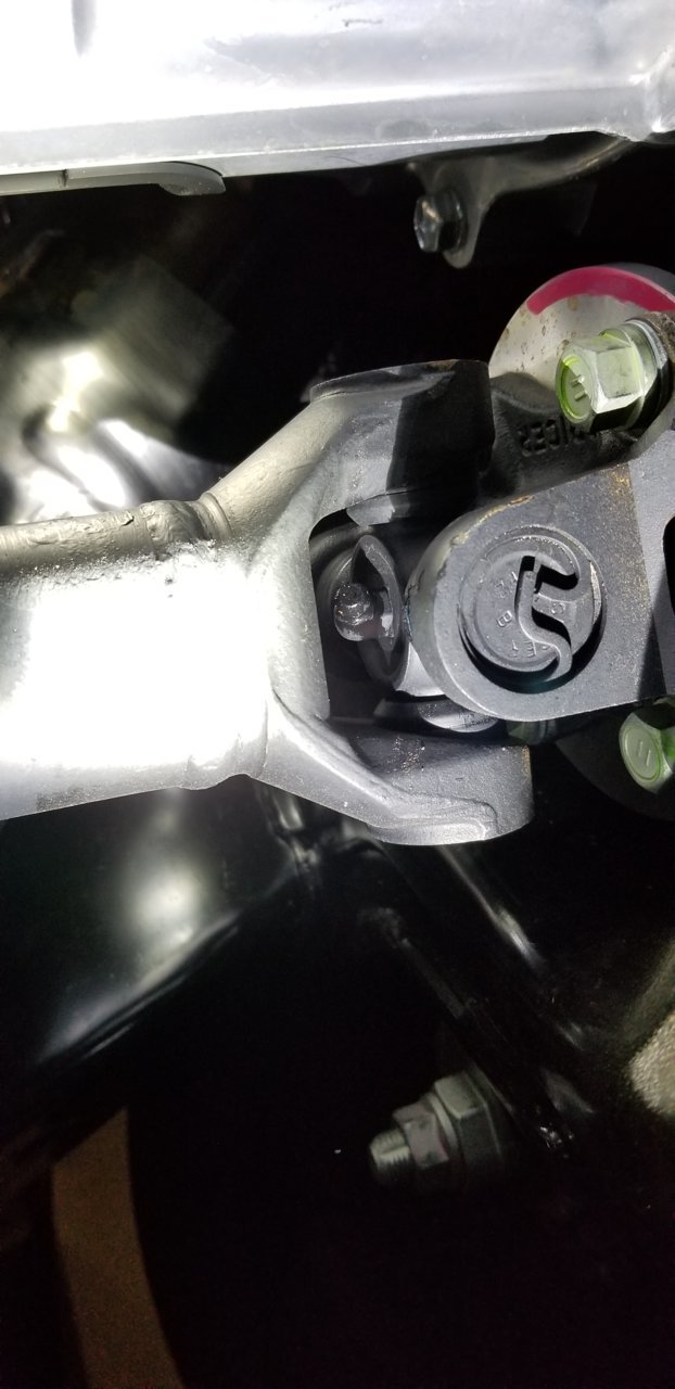

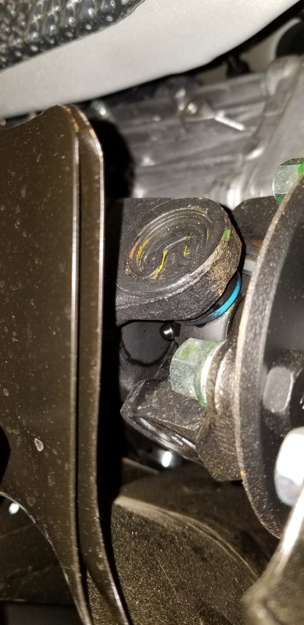

    I've got 443 miles on my 1 month old 2018 Off Road 4x4 manual transmission and I can confirm what others have been saying; I've got no zerks in the rear and two zerks up front.
    I did notice that the zerks up front on mine had lube on them so I take that as a sign it's been lubed either at the plant in TX or (don't laugh now) at the dealership. I'm thinking it was the dealership because they provide their own lifetime warranty outside of Toyota's warranty. Regardless of whether it was done at the plant or the dealership, I'm grateful for the extra step and effort that was put in.
    To each their own, but as for me I'll definitely be purging in a few thousand miles and will maintain as per the maintenance schedule. It's only logical if the zerks are there and the manual says it's part of maintenance, but as evidenced by some of the naysayers in this thread alone, logic and reason escape us at times... human nature I guess.
