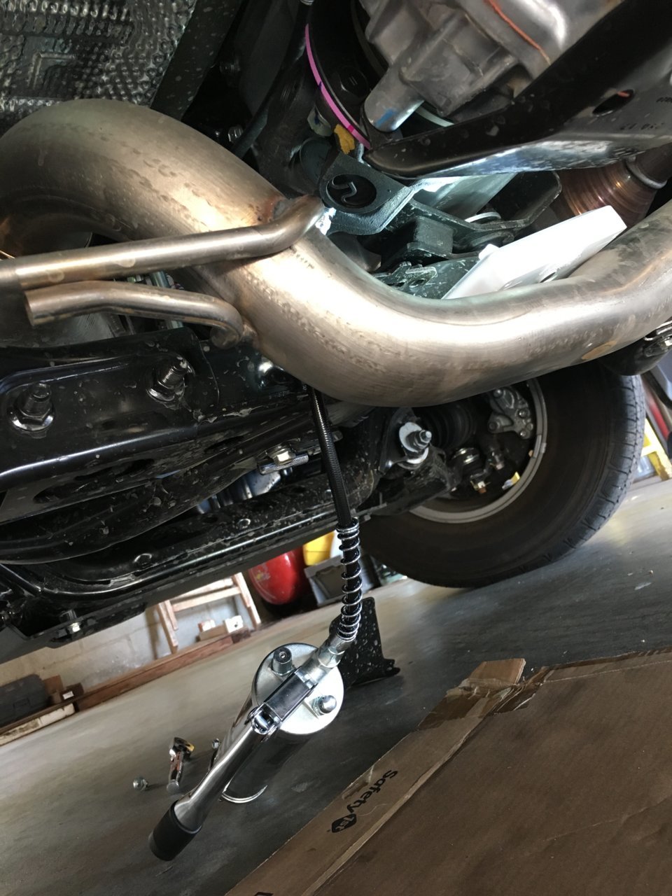

    I finally got around to this. I bought this stuff at Harbor Freight with a few other things due the Mother's Day sale: I also grabbed a new flex hose to fix the grease gun that I had from my Dad. He had a nice collection of tools from his mining days.
    I was surprised that the standard end worked. I had my needle end ready.
    The joints purged nicely and even with a good clean up, slung some on the exhaust.

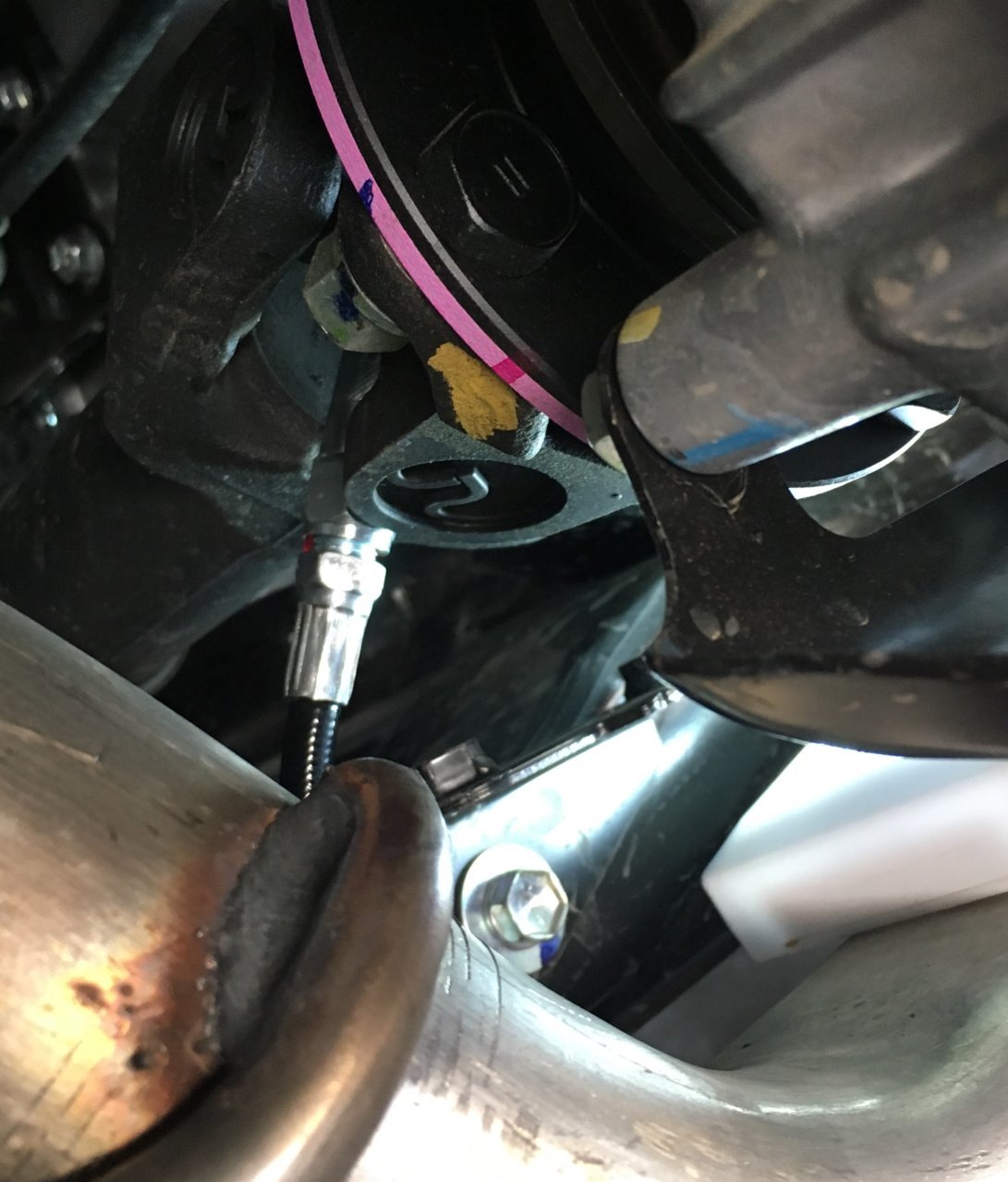

    Took 4 pumps to hear the 1st purge, and took several pumps to purge the black stuff out of all 4. Doing the infamous rear zirk next. Thank you for the heads up to all that contributed. TW 3rd Gen has some BIG hitters.

    Rear took 1 1/4 pumps. Quickly purged black stuff. Needle did not look dry. Forgot to check front. This was the best location to hook up for me.

    @Topanga Taco 's second pic above shows the gun connected to the zerk on the aft end of the front shaft.
