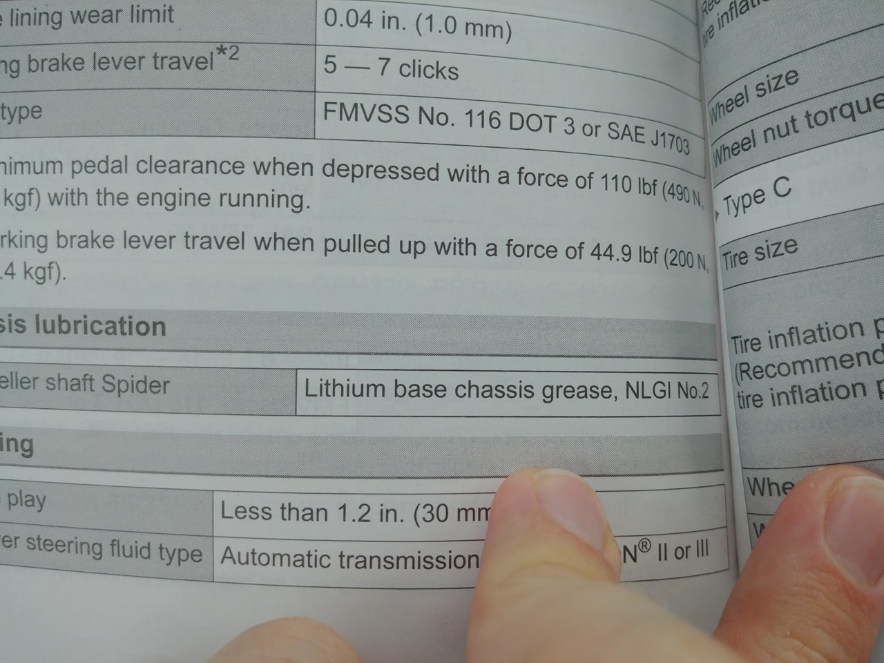

    Sorry if I missed it.... What is the recommended grease?

    2016+: NLGI No. 2 Lithium Grease.

    Thank you very much...

    I've had two older Toyota trucks and two Tundras. All manuals recommended, and appeared to have been greased with, a moly fortified grease. I have never had to replace a joint on any of these trucks and all went to 200K miles, Tundras to 238K. I haven't done the front front ones yet on my new '18 Tacoma, 2800 miles and will do this weekend. Likely the black grease some refer to see being purged is moly grease, not some light assembly crap. I use Amsoil synthetic moly fortified grease. FWIW, the sealed axel shaft CV joints use this type of grease.
