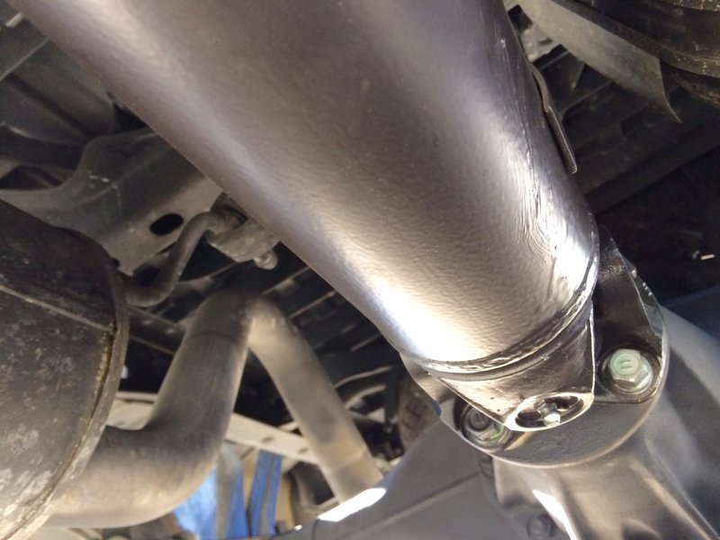

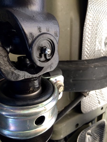

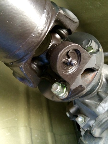

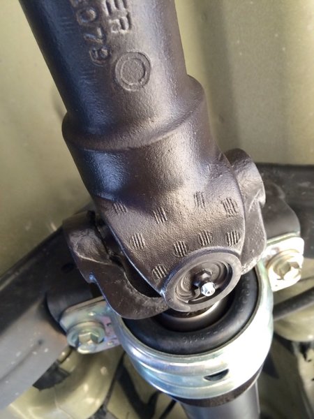

    I have a 2WD 2013 Prerunner Access Cab 2.7 and I definitely have the grease fittings.

    Those u-joint pictures were taken with my iPhone 5. I'm in Florida so there's no snow/salt roads eating up the undercarriage. It's got some wear with 37K miles but it's still in great shape. I don't off road much. Occasionally I'll get on rougher dirt or sandy roads for mountain biking or kayaking spots but mostly city/highway driving.

    Are you sure those weren't install after sale? They seem WAAAY too accessible for from the factory.

    They look just like the factory ones on the 2016 Tacoma. The grease fittings for the front shaft aren't as accessible as they fill grease into the cross instead of into one of the cap ends.

    I stand corrected, I had always heard the 2WD didn't have them. I guess it changed at some point. Better to have them IMHO. :cool:
