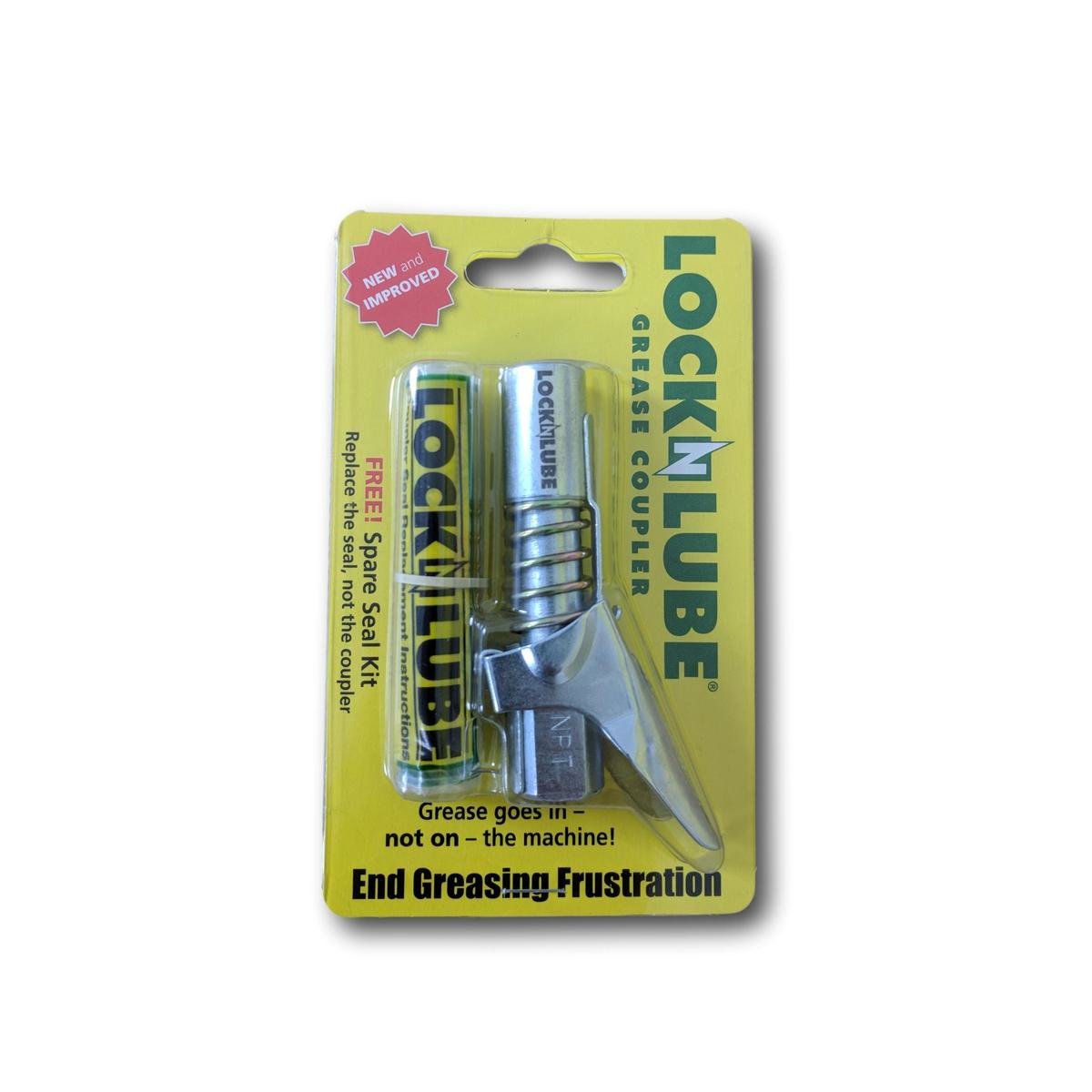

    As long as there’s room, these are the bomb..
