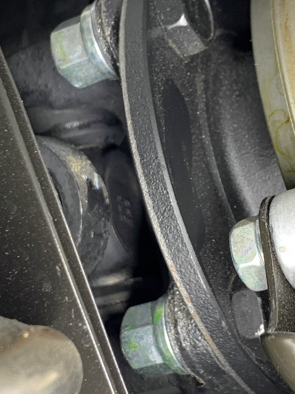

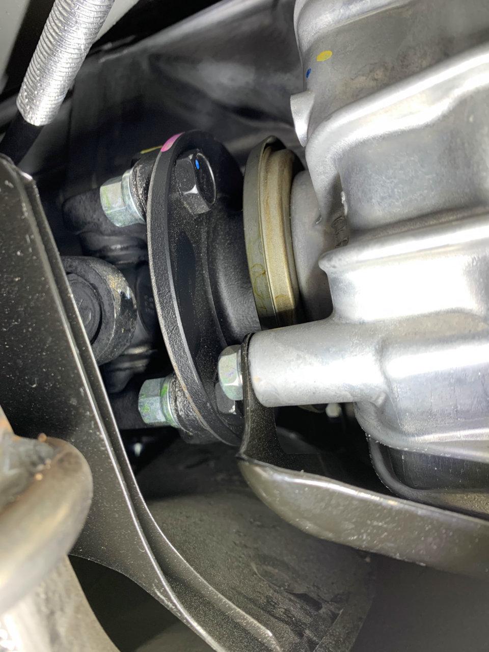

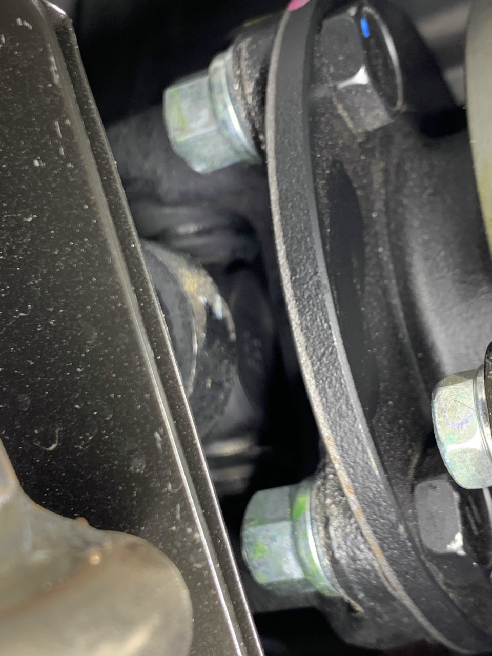

    Just went through almost the entire thread. Just checked the front shaft on my 2021 Pro, and didn't find any. Obviously checked the rears and nothing as expected.
    I tried taking some photos for reference. Am I perhaps missing something?
    rubiconjp likes this.

    Thanks for the reply. Not sure if you saw my photos, but I checked everywhere and its my understanding that the zerk fittings are in the "crotch" of the spider. I tried feeling for them and you can see in the photos, that they are not there.

    They eliminated the zerks from the front shaft over the past couple years too.
