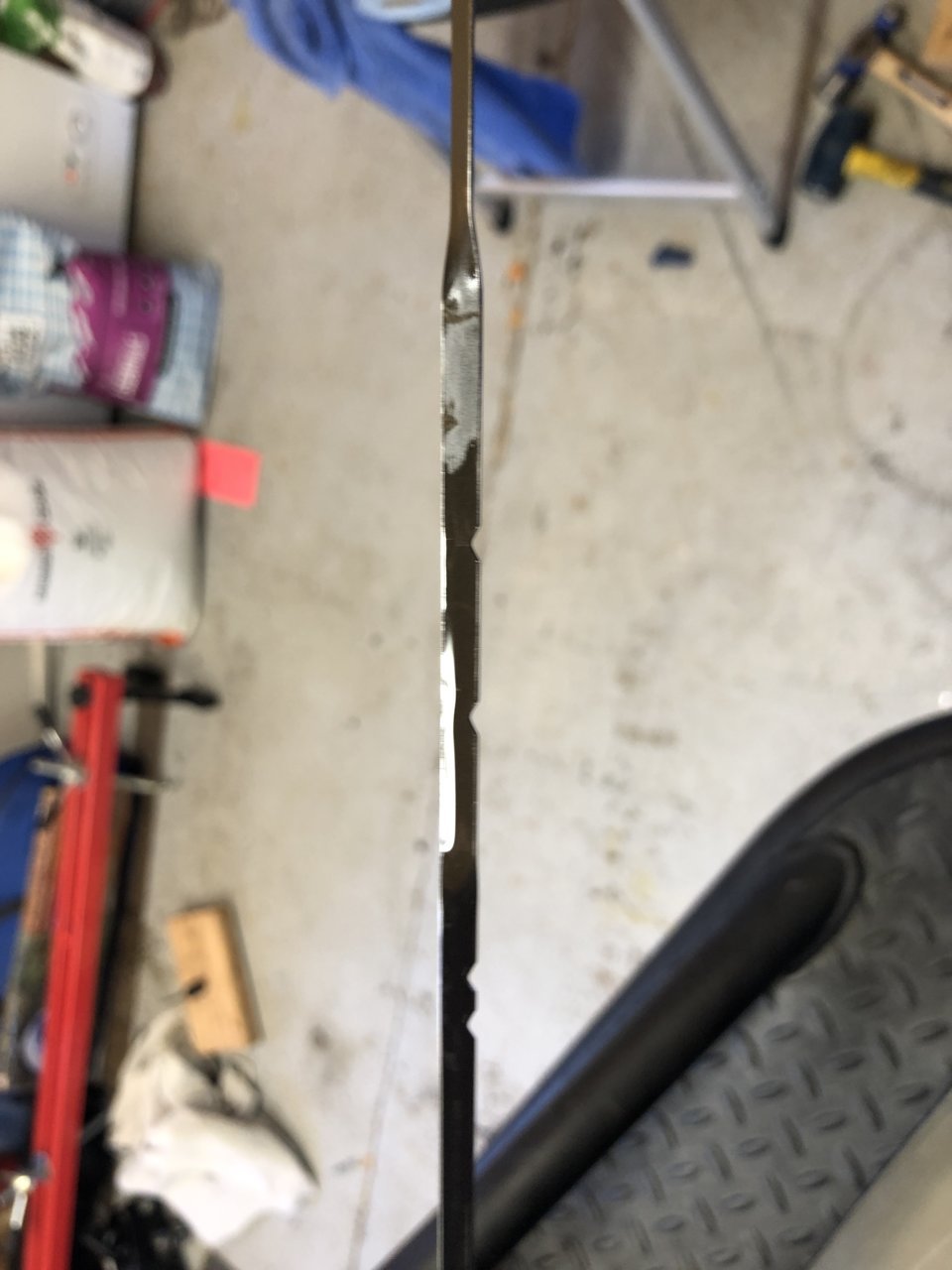

    Would you at all be concerned about this level?

    I’d be concerned about that color. Needs a flush for sure.

    Really? I wonder if it's just the picture. The tranny is full of brand new fluid. It's been in for about 8 days. It looks pretty much fresh out of the bottle.

    Is that not the oil dipstick?

    Tranny dipstick. The level is above the two HOT markings. I'm just wondering if I should drain some out.

    If you put new fluid in, it should be reddish. That looks black like oil.

    Ok, suppose we get past the fact that the photo is not the best and focus instead on the level. Do you have any thoughts on that?

    I'd drain a bit out. Don't want churn it up and make it foamy.
