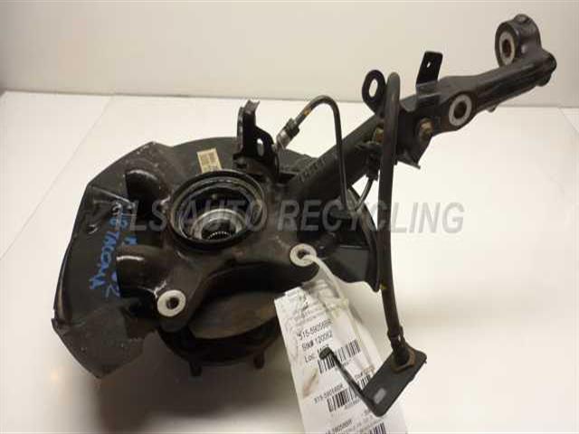

    re: buying a set of spare spindles for $100-200, used OEM
    to send out for gusseting,
    How do you know if they're bent or not?
    Like how do you know the person wasn't hitting curbs and doing youtube jumps on 4600's,
    then goes "Perfect Condition"
    Is this something a fabricator would know once they go to line up the gusset parts against the spindle and if there is too big of a gap or it doesn't bolt up to a jig that would tell them it's bent?
    Maybe they're strong enough to survive driving so long as it's not from a junkyard truck that obviously got crashed on the side of the spindle?
    I'm actually curious to know if any of mine are bent and plan to get under the truck with a tape measure to connect various points and connect left to right
    Or maybe the best way is to buy those $120/ea brand new ones from RockAuto, take off the old spindles, and hold them next to each other to visually compare?
    Usually on a regular car, any time there is an impact, you just assume and replace a spindle. But they're aluminum meant to bend in impact.
    As opposed to trucks; these Tacomas go through a lot harsher terrain regularly compared to a car
    Last time I saw a similar looking iron spindle was on an '01 Mercedes E320, W210 chassis

    They do bend easy. Best way to compare next to a known good one and the results are pretty obvious.

    Simplest way to tell if they are bent when they are on the truck:
    Alignment is way off from one side to the other (could be something else damaged, doing other checks could rule out other components)
    Gap between the tire and the upper ball joint should be pretty equal (this will only tell if the spindle is bent inboard towards vehicle centerline, NOT bent forwards or backwards)
    Could probably take the tires off and compare the angle difference from driver to passenger with a gauge, but this would likely vary depending on alignment and might not be a good way to check.
    If they are off the vehicle and stripped down, you can place them back to back and they should have equal angles as they branch outwards and up. Probably could tell just with your eyes, but could also put an angle gauge on them and compare them with them on a table sitting upright.
    Yes a fabricator can tell easily if he has a jig and can probably eye ball it using the back-to-back method if they have a known good spindle.

    I have a JIG that I built that actually tells me in “degrees” how much it is bent. I don’t like to share pictures of it so people don’t copy it.
    The quick and fast way to check is to put it on a flat, level table. Put a level on the top of the knuckle. It should be level horizontally when you spin it. Same goes for the side of the spindle where the tierod attaches. Should be level vertically there as well.
