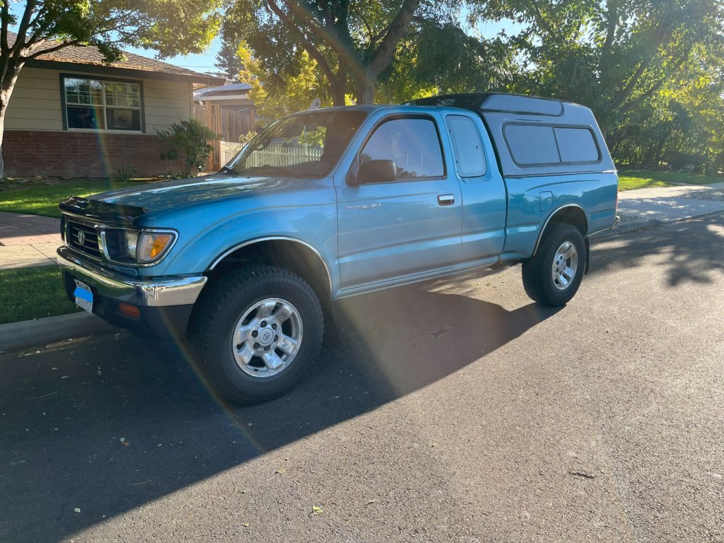

    Hello 1st genners,
    I recently acquired a new 1st gen: a 1997 Tacoma 5-speed 4x4 Xtracab with 164,000 miles on it. It came from a loving family that did a lot of good maintenance on it. I've been going through the maintenance records, and the following work was done on the suspension in January of 2023:
    First the material description:
    • 90369-54002 R-F wheel bearing
    • 43502-35170 R-F wheel hub
    • 90312-95002 Outer wheel seal
    • 90316-69001 Inner wheel seal
    • 88-1573x P-S rack boots (2x)
    • 2610-326594 Innter tie rod ends (2x)
    • 45064-3928 L-F outer tie rod end
    • 45047-39175 R-F outer tie rod end
    • 08921-04950 Cooling fan clutch
    And the labor description:
    • Replace R-F wheel bearing and hub
    • Replace inner and outer tie rod ends and boots on P-S rack
    • Replace cooling fan clutch
    • Front end alignment
    That's it! So I think I need to still replace the LBJs to get a baseline? I am planning on putting the truck on a neighbors hoist this weekend to test the LBJs, but am leaning to changing them out if not 100% sure they have been recently swapped. Also I'm quite puzzled why they went through all that effort and didn't replace the ball joints when they were at it!
    Comments welcome, thanks!
    Cheers
    TxIn
