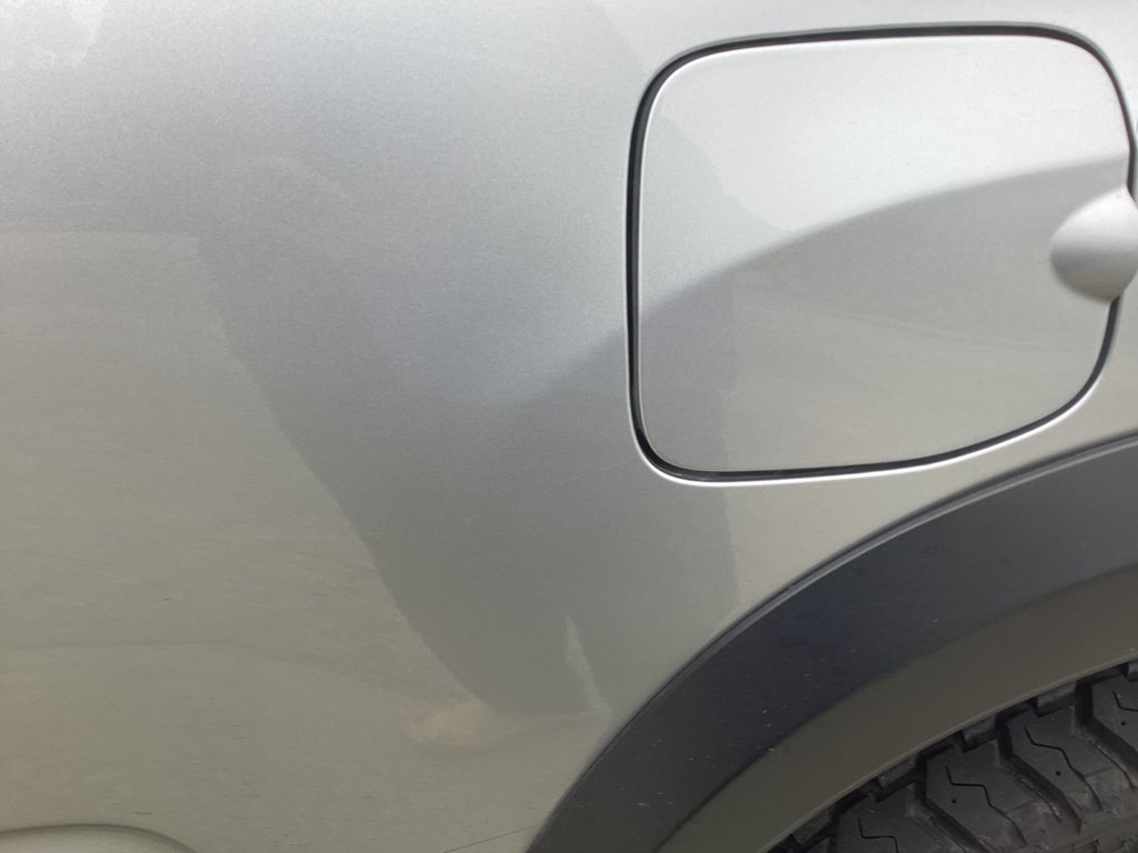

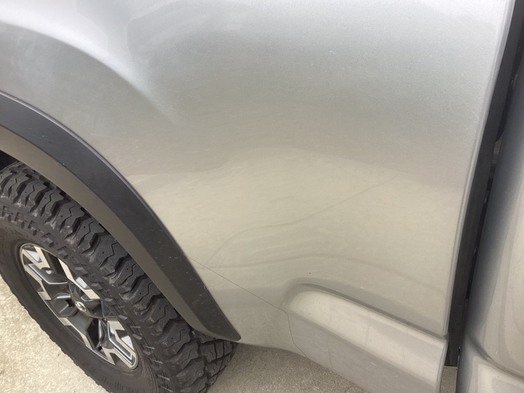

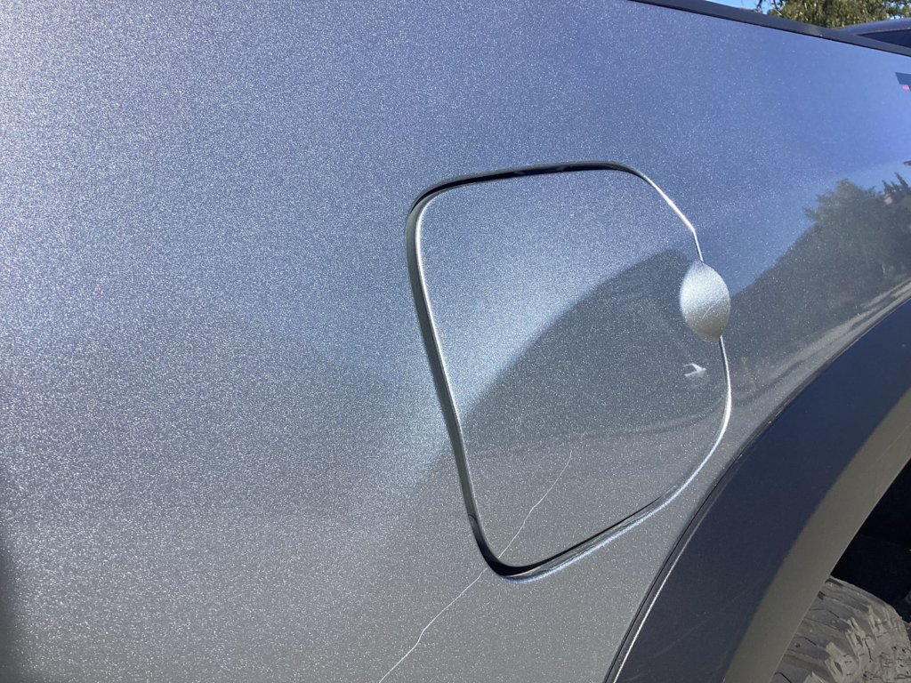

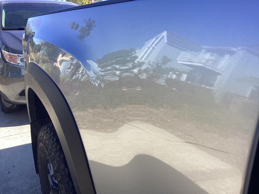

    My Tacoma got a number of scratches last year from the brush at an off road park. I did the typical internet research and decided to try the Chemical Guys product.
    I used a mild blue Scotchbright pad by hand with a drop of the scratch remover and a microfiber towel to buff with.
    My guess is that there are a number of scratch remover products that work just as well but I'm happy with the first one I tried.....Of course, if the scratch's go all the way through the paint the results would not be as successful.

    Came out nice , a little aggressive though . But all good . Most scratches can be polished out in a much less aggressive manor . Be careful clear coat on newer paints is thin .

    I agree, I appreciate your comments, that's why I did it by hand with a very light touch.
