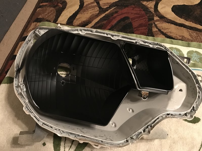

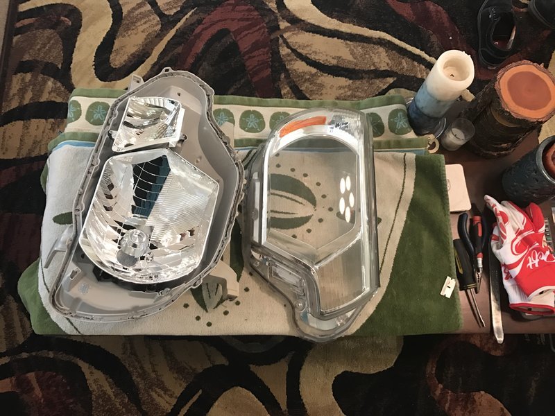

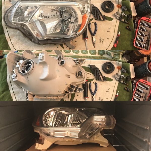

    Getting started on the headlights

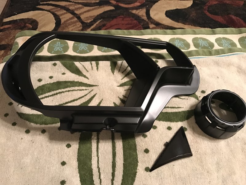

    Painting is complete. The amber reflector has taillight tint spray so it'll still reflect at night but damn near black during the day.

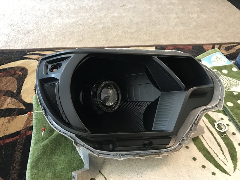

    Gotcha. Well for now here's a little preview :D
    The H4 plate would line up perfectly, but the stock bulbs are mounted at an angle so the projectors rotation is off. Going to be some work to pull my front end apart, wire up the lights, mount these and work on adjusting the rotation :goingcrazy: if only I had a driveway haha
