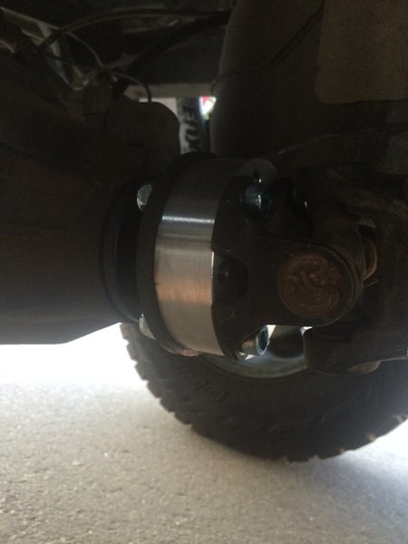

    Driveshaft spacer installed and my taco is back on the road again! Just did a quick test drive around the block and everything appears to be in working order. Tomorrow it'll get a quick run down the freeway to make sure there aren't any high speed vibes.
    After the lift my driveshaft was essentially stretched. Caused the carrier bearing to be pulled backwards towards the rear differential and burn through the center support bearings. 4crawler ( http://www.4crawler.com/4x4/ForSale/DriveshaftSpacer.shtml ) makes a spacer that bolts right up and adds some length. Now my carrier bearing is where it's supposed to be and should last longer now.
    For future use our driveshaft yoke / flange bolt pattern is 65mm x 65mm. The spacer I used was 1.25" but a 1" spacer would have worked just as well.
