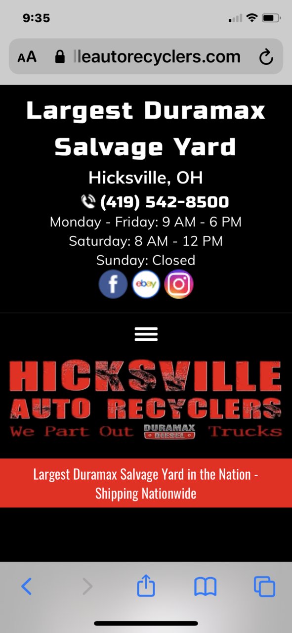

    No usable core is probably the reason for the huge estimate...That would be the first generation Allison which was a five speed which I believe was used up till 2005. 2006 and after I had an additional gear… Anyway here’s the name of the largest Duramax recycling yard in the country. Might not save him time or money but it might be worth a call.
