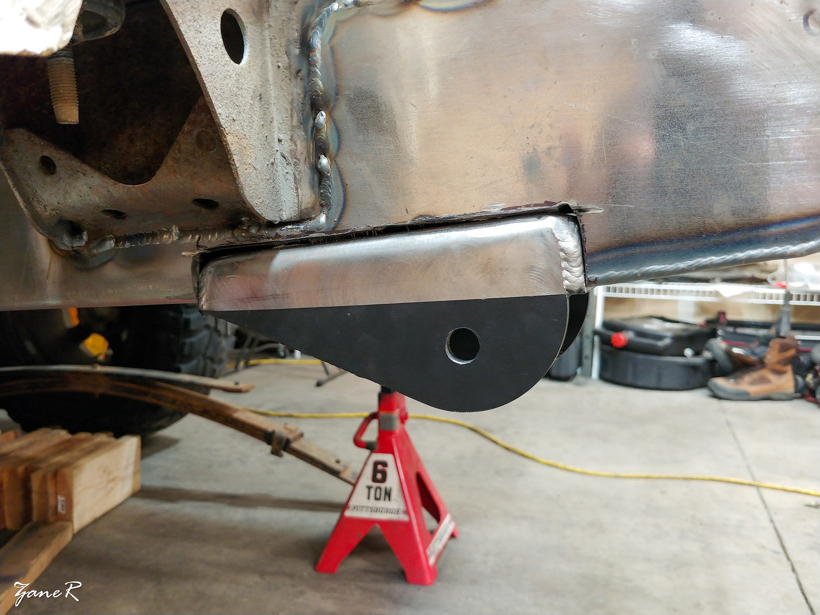

    Yeah you can definitely do the job in a weekend if you have everything ready to go, just depending on your level of fabrication and welding skills.
    Frenching the hangers is just recessing them into a pocket in the frame, so you sit as low as possible. Since the front hangers have to be moved forward something like 11”, they’re down on the flat part of the frame and add significant ride height due to that.
    @Speedytech7 ’s frenched hangers:

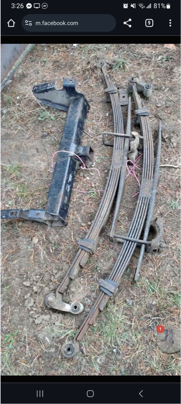

    IMG_1418.jpg Just picked up a set off a 94 3/4 ton, 4 leaf plus overload. Is the set you guys are using have 5 leafs plus overload?

    Mine is. (5+overload)
    Not using the overload, but I did buy an add a leaf in case I need it.

    I might have to go look and make sure lol
    At some point in the 90’s, Chevy switched from 4 thicker leaves to 5 thinner ones for the 3/4 ton trucks, same load capacity though.

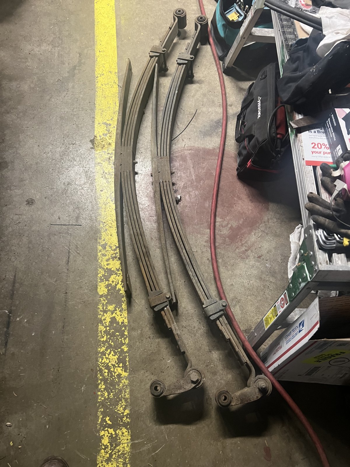

    Hmmm, what’s the leaf count/specs on what you are you running now?
    I carry a lot of weight as well, part of the reason I’m swapping- I have T-100 rear leafs, they’ve done well for a long time but they are really tired, starting to bend the main leaf and started to have some bad body roll when loaded up. Added a rear swing out and things are at times scary now.

    Fox 2.5 DSC resi CO's w/ 700lb King Coils, Camburg uca's, T-100 rear leafs, 13WL Tundra brakes, 1" 4crawler body lift, 295/75/16 Hankook MT, Ruff Stuff u bolt flip, 10" Fox LSC resi shocks turned back on custom mounts, home built rear high clearance bumper with dual swing outs, Diode Dynamics SSC2 Pro rear floods, Skid Row front and transfer case skid, home built transmission skid, Mercerfab sliders, home built front bumper, Badlands Apex 12k winch with synth line, 4.56's, ARB rear locker, LonePeak wedge camper, eBay snorkel, Sierra LEDs 20" dual amber/white light bar, Diode Dynamics SS3 Max amber fogs, Mini D2S projector retrofit, Blue Sea ML-ACR, dual Odyssey PC1200's, 100 watt solar panel, 20 plate heat exchanger/home built shower kit
    Yeah, Dan, I think when I asked you, you said you got yours off a 98.
    From what I’ve read (and there is so much info out there) the earlier springs had a bit more arch. After a point they also switched from 9/16” spring eye bolts to 5/8”, but if you’re swapping the bushings just use the set that has the 9/16” bolts.
    I’m using the Ruffstuff kit as well and planning to French the front spring hangers, want to get about what would likely be 2-1/2” over stock- I like a little bit of rake, better to keep the headlights down at night and frankly hate the ass drag look
    Think I fixed it, I’m not seeing the pic

    I think I fixed the pic... if not, here it is again:
