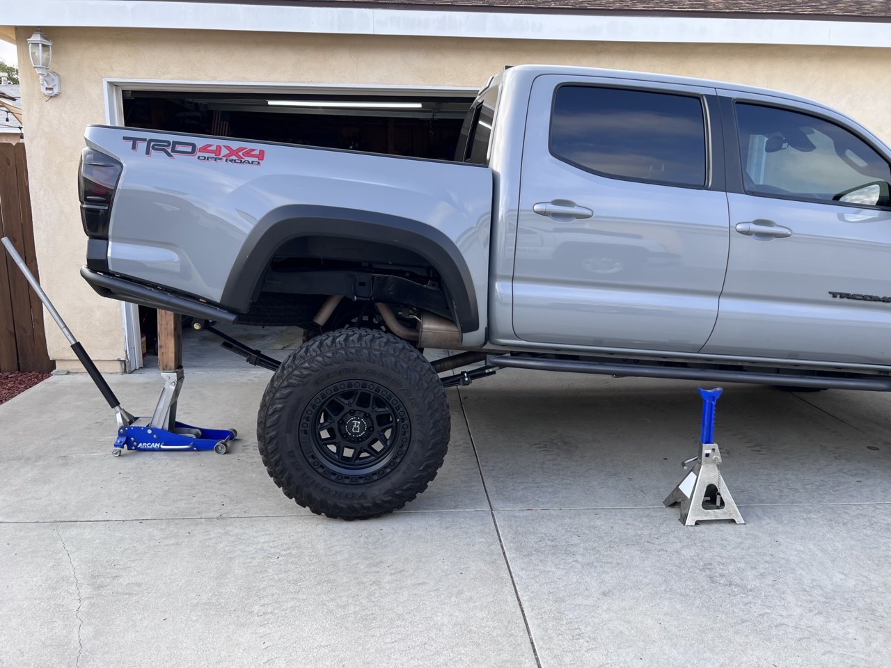

    The goal is to keep the axle in the same location so you don’t need to have the driveshaft resized. Use a plumb bob and mark the bump stop pad where it lines up with the top of the axles center.
    Then measure the removed springs center bolt to the eyelet, repeat on the Chevy springs then subtract the difference and add 1/2” for the spring to flatten out under load. For my truck this number was 4.75” this is the starting point for how far forward your new spring hanger should be mounted in front of the stock spring hangers.
    Tack those in place and tack the rear spring shackle hangers anywhere directly above the spring eyelet. The shackle hangers location will depend on how much weight is on the back of your truck, desired shackle angle, and desired ride height. You’ll come back to that just focus on the front spring hangers for now until the axle is verified to be back in the center location. Adjust if needed.
    Make sure the springs are completely parallel the front spring hangers, axle perch, and rear shackle hangers should have the same center measurement.
    When setting the rear shackles make sure you have your daily driving load on the truck.
    Makes sure both shackles have the same exact angle.
    On my truck with my daily driving weight and the height I want the back of my truck to be I have my shackle angle at 35 degrees. For reference I had to cut my tack welds on the shackle hangers twice and relocate them before I got my desired angle.

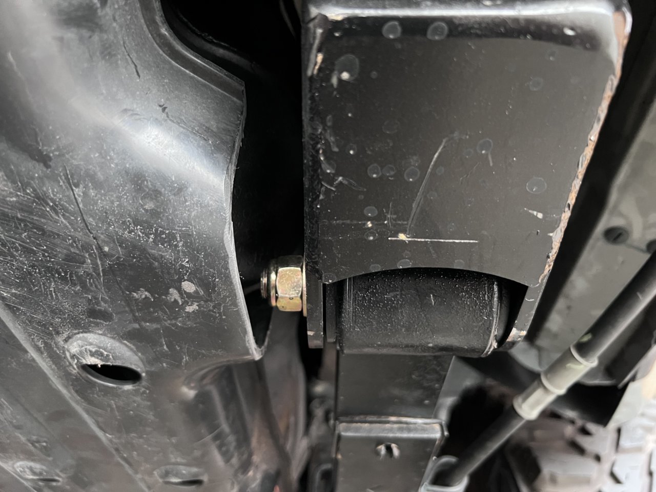

    Here’s a picture of the gas tank cover I had to cut back. A cut off wheel made it quick work.
