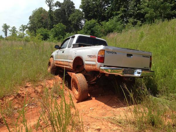

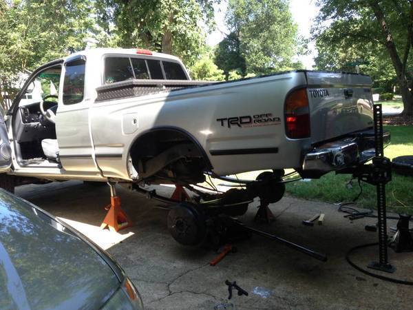

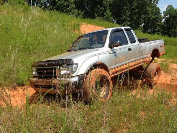

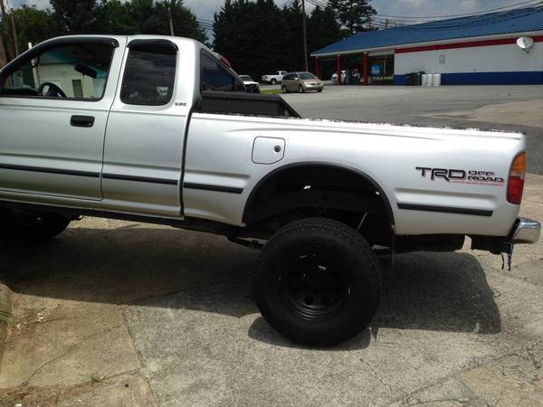

    I am not done with my rear end setup but have been running the 63's for over 6 months now. Flex is very nice, ride quality is meh.. I still plan on doing 6" shackles, creeper joint shackle hangers, and ditching the overloads. Here are a few pics of my current setup.
    Stock leafs, stock shocks
    Same hill with the 63's, 12" stroke bilstein 5125's, stock shackles
