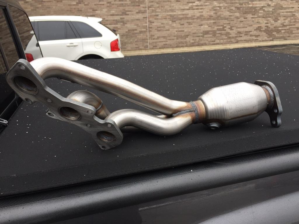

    Dude!!!! I had thoughts of doing that too. What brand did you go with?? You had to buy the cat deletes right?

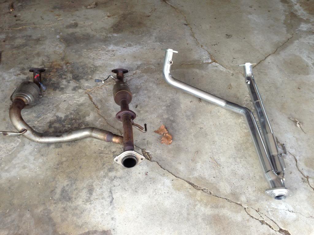

    They are AFE and I was excited to find a place on ebay that had an incorrect price, but they honored it when I bought it. The AFE headers have the first CAT built into them so you do not need the CAT DELETE. The headers will be dropped off today for a high-temp coating on the outside. I have installed a mid-pipe already that deleted the rear CATs, but the computer does not care about those so nothing was needed to install it.

    So no check engine light or emmission failure when you go get it done?

    No, the 4 O2 sensors just monitor the first set of cats. Removing the 2nd set does not effect the computer.
