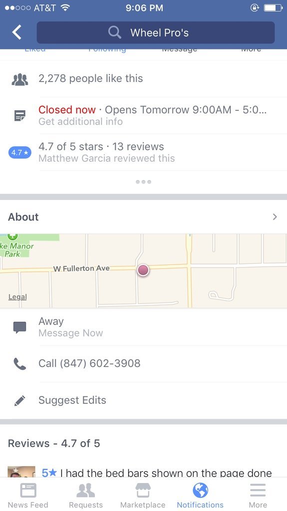

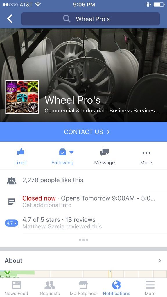

    Any recommendations for a local painter to prep and powder coat some parts?

    Fow Valley Sandblasting in Yorkville Illinois.

    There is a place in crest hill......200 bucks for a set.
