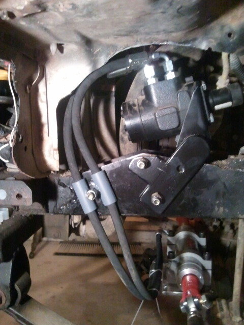

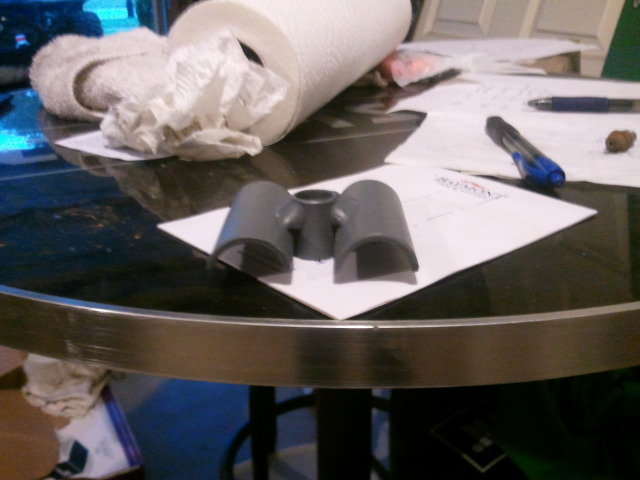

    Well I got a bit more work done on Erics steering saturday.
    First off I measured the TR positions to determine the correct ram location. Currently the ram is 6" c/c with the axle and it looks like it needs to be 5 3/4" so looks like the bracket we made will accomodate just fine. I also measured for the stop tubes which will be taken care of this week as well. 2" stop tubes will stop the ram just before the knuckles contact the steering stops.
    Eric had the correct borgeson U-joint sent to me last week, which is 3/4" on the orbital valve side, and a "DD" style shaft on the other. My only complaint is that only the one side was drilled and tapped for set screws. And since the valve input shaft is smooth I had to come up with something for attaching this end. I ended up grinding to small flats 90° apart and tapping the u-joint for some set screws as well.

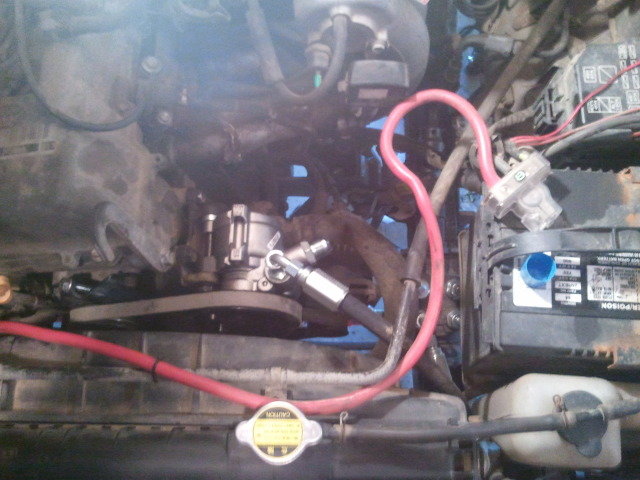

    Moved on to mounting the TC pump. The pump does not fit great in the factory bracket so I...used some steel spacers to "space" the pump to the front side of the factory bracket, this puts the pulley where it needs to be. This would have been trick http://www.chilkatdesigns.com/PumpBracket.html but for now the factory bracket worked out fine.
    I used a bolt and washer to pull the PS pulley onto the pump (while holding the pulley), to avoid damaging the pump internals. Also the hub with the groove goes outward so a pulley remover can be used later when neccessary.
    Decided to run the pressure lines to the ram on the outside of the frame for clearance reasons, and made a bracket from some 3/4" black pipe and a steel sleeve. This should locate the fixed end of the lines on the frame rail and keep them out of the tire. It also utilizes a steering box bolt no longer used. The center sleeve is a little long on the frame side to prevent overtightening the bracket and pinching the hydraulic lines :
    No real issues so far except for relocating little things (relays, airbag sensors, small wiring, etc.) and need to re-route the lower radiator hose as well.
    Next up is mounting the reservior.
  4. Aug 13, 2012 at 6:29 AM
    #1024
    NwiTACO
    NwiTACO Big tars, little/no bed.
    May 19, 2009
    #17416
    4,428
    Mark
    Indiana
    05 TRD Sport
    Custom Everything, 1 Ton Axles F & R
    They are about 1/4" away. I cut some more fender away already and theres not much more I can take out. I am gonna put some door edge crap on the cut, but the hoses shouldnt move enough to create a problem.

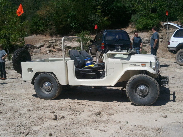

    Sweet cruiser (resto just finished):

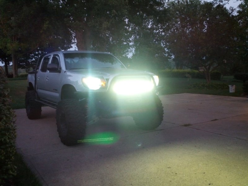

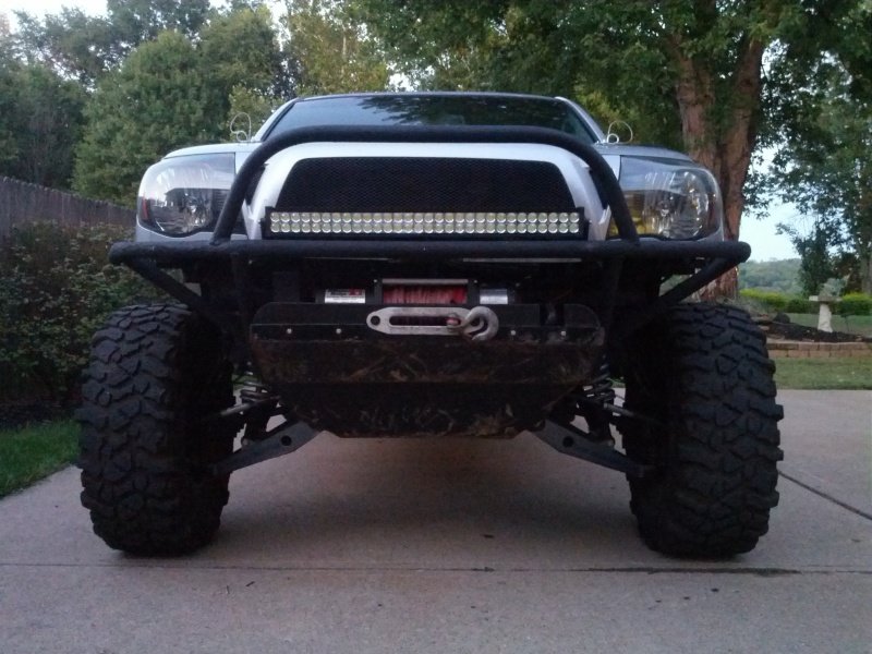

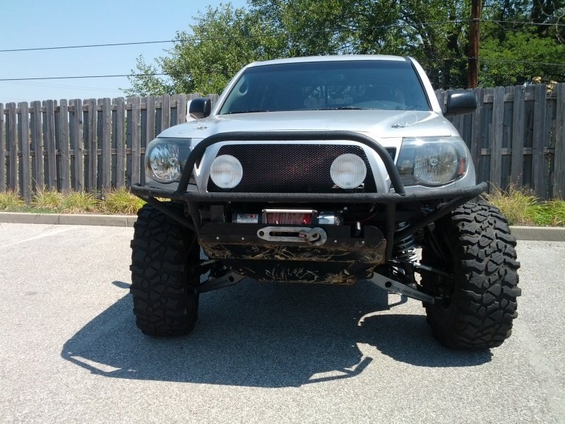

    Some stickers
    I have hated these since day one.. yes they where bright w hid retro but still couldn't stand the look
    I finally bit the bullet..
    So much better

    Very nice Nick, if that bar is missing one day it isn't me :anonymous:
  20. Aug 27, 2012 at 4:38 AM
    #1040
    ChiTownTRD
    ChiTownTRD Toyota Nut
    Oct 13, 2008
    #9955
    203
    Chicago
    2010 fj cruiser, 2010 Tacoma
    How big is that bar? Fits the bumper perfect!
