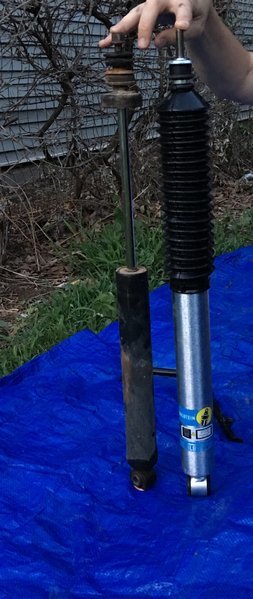

    Changed out the rear shocks with Bilsteins 5100's. I used a little wd40 to lube things up to get the old ones out and the new ones on. It was a bit hard to compress the new shock so I dropped each side pretty low so I did not have to compress as far to get them on. As you can see the 5100's are slightly longer than stock.
    Had to improvise to get the stock ones off. I had to cut the passenger side off due to it literally deteriorating. I kept the drivers side to use in a pinch if I blow a shock somewhere.

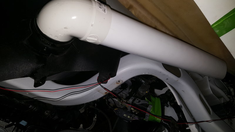

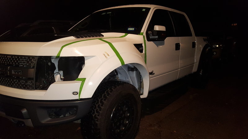

    My wife is not on here, but she is on the Raptor forum. She has done fender swaps, with a little help she has semi snorkeled her Raptor, and now I dropped off somemore work for her for her Birthday lol. Some guys bring home the bacon, I brought home the goods lol20160515_215116.jpg 20160515_215133.jpg 20160617_204110.jpg

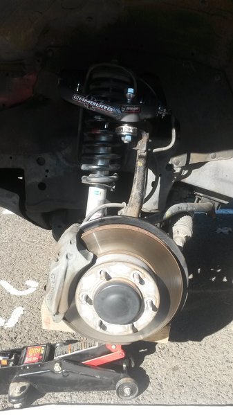

    I love this thread! I have limited automotive experience and have learned a lot from TW. Switching out my UCA has been my "largest" project this far unsupervised. It was very rewarding and I learned how much I hate ball joints!!
