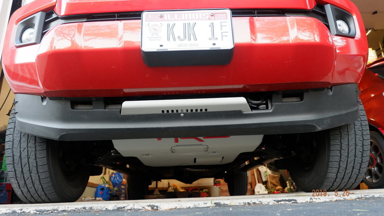

    What did you use to make the cuts that clean?
    Thanks!
  4. Dec 8, 2021 at 9:02 PM
    #64
    jerkwithkeyboard
    jerkwithkeyboard Well-Known Member
    Feb 15, 2016
    #178231
    980
    Western suburbs Chicago, ILL
    2016 TRD Sport DCSB Inferno 4x4, loaded /JBL/Tonneau Cover/ Roof Rack
    17" Black TRD rims Tacoma Stainless Steel Rear Tailgate Letter Inserts Brake light flasher Center LED 110v and 2-3amp USB plugs mod in back seat center 400w on all the time mod SSR-610-40 SumoSprings 32 INCH 180W CREE LIGHT BAR (5D ) AUXBEAM BedStep and Pop & Lock Power Tailgate Lock Blue LED glove box light (fix no light) Bed light Blue LED's Wired to turn on when Gate is opened Tempered Glass Center Touch Screen Protector Rear Camera anytime Navigation Bypass ( a must) Rexing V1 3rd Generation Dash Cam hard wired in OXILAM 912 921 LED Reverse Light 2000 Lumens TRD Pro Grill TRD Skid plate

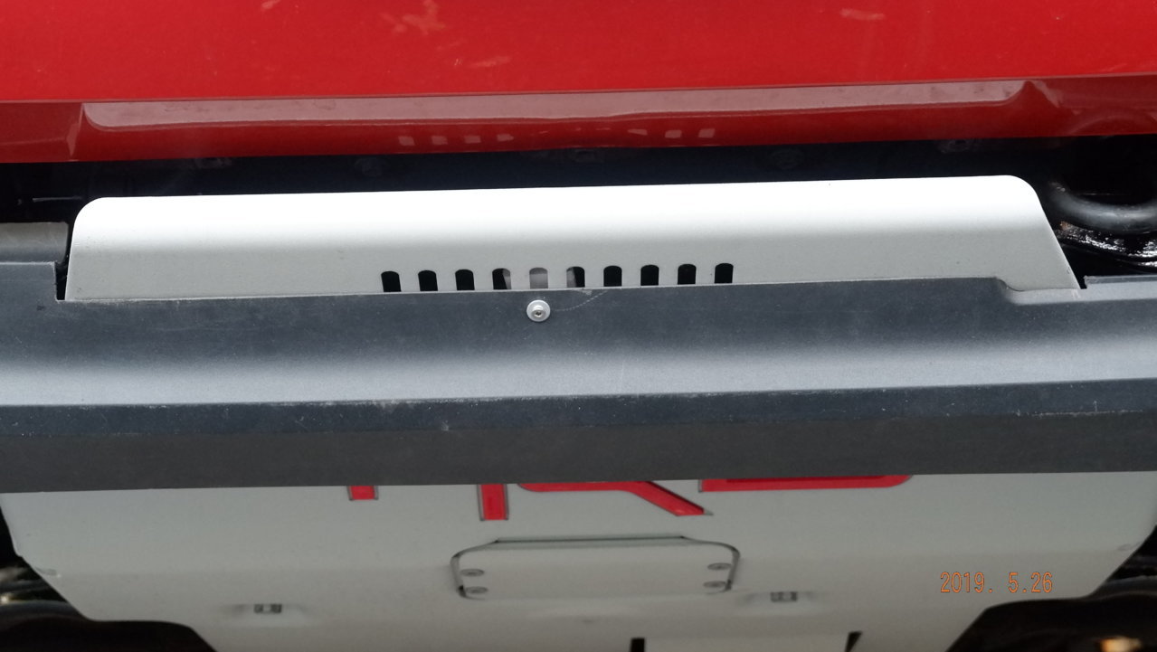

    I used one of these, worked really well as you can trim just a little at a time and not slip as with a knife/ blade.
    Worked way better than i thought for a $15 tool i had, (not that one) Oscillating Multi-Tool
    its been on for a few years know.
    Used a screw in the middle with a small piece of plastic wood (white) to hold it together.
    Still very easy to remove if i need to

    Hears a different pic of it for you.

    Awesome! Thank you!
    I was thinking of using a jigsaw but wasn't sure how clean it would cut. Never would have considered an oscillating tool.

    Just keep cutting a little bit at a time because you can't put it back on. i probably trimed it 5 to 10 times to sneak up on on...
    good luck
