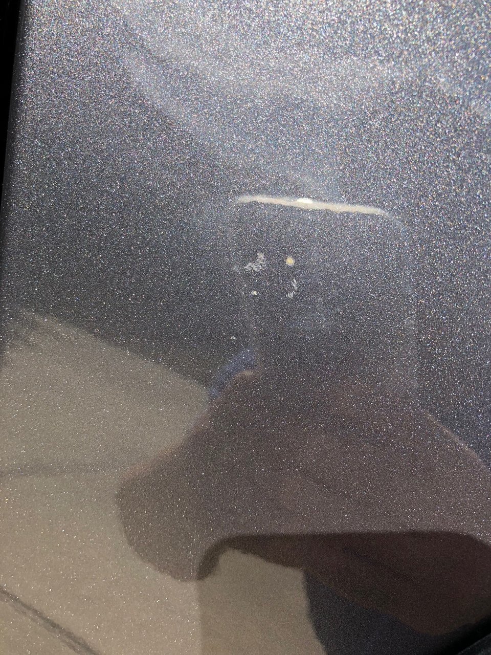

    Hey guys, I just got a Tacoma last week and noticed a chip and a scratch this morning (courtesy of our neighborhood lawn care). I used the Meguiar Scratch X and it helped somewhat. Any idea on how to remedy this issue? Dr. Colorchip? OEM touch-up paint? Really frustrated right now and could use some advice. Thanks

    A polish or wax isn't going to do much with what your picture shows. Those types of products only work when you have fairly light scratches in the clear. The scratch you have appears to be through the clear coat and color, and into the primer. The Dr. Colorchip system works fairly well based on personal experience, but will not totally hide that type of scratch. The only way to totally correct that bad boy is going to a Body Shop and getting it re-painted.

    Yeah going to the body shop for that small damage seems a bit excessive. Some touch-up paint will suffice I feel.
