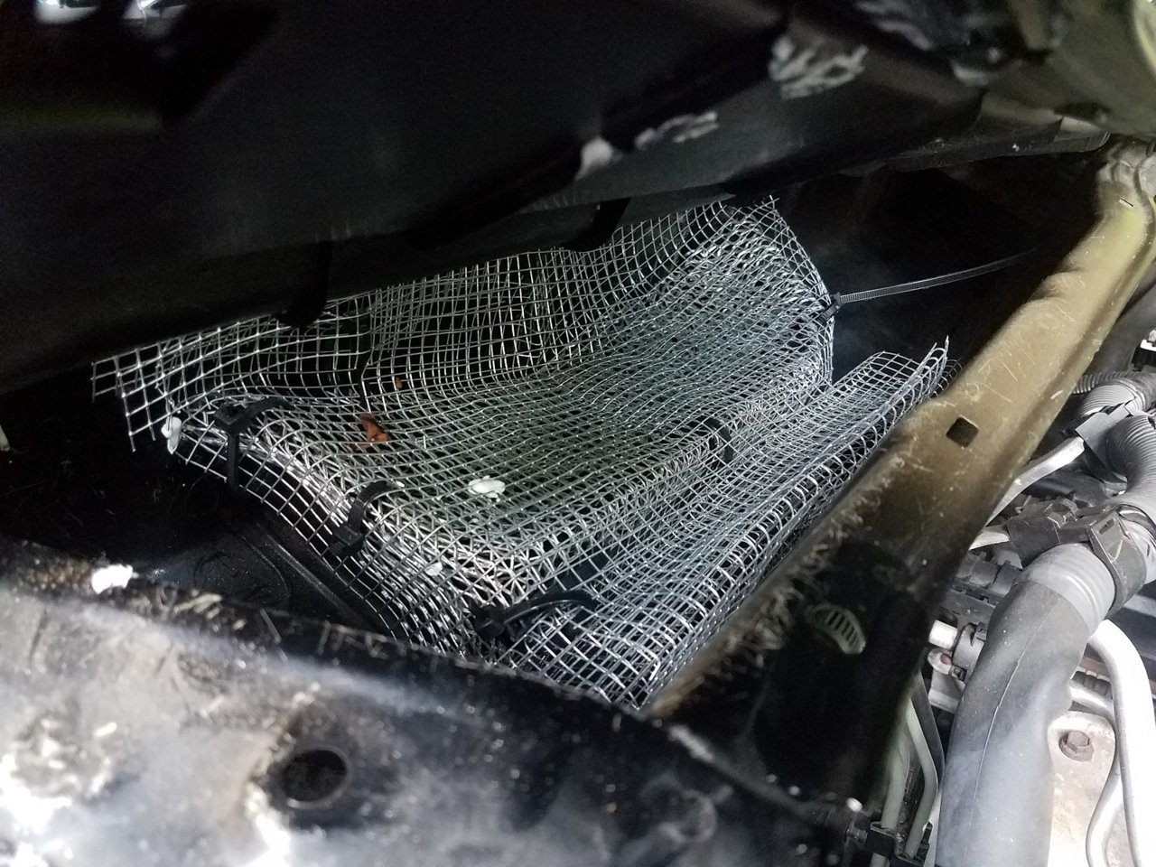

    Here is the hardware cloth screen i used to block off the opening to the blower fan.
    This is on a Gen 2 but the opening is similar on the Gen 3. make sure it has no gaps and is tight.
    Takes less than 30 minutes and you wont ever have them getting into the vents.
