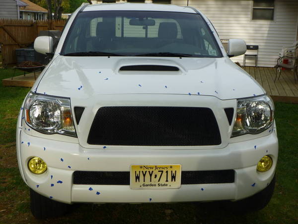

    i have some places where the paint has chipped very small showing bare metal how can i fix or paint to get it to look a little better need some help on this one guys its really getting under my skin

    i just need to know the best way to do this so its less noticeable and not spottie and blends into the stock paint

    What color is your truck?

    Color matched paint from your dealership and this:

    get the stealerships little paint bottle, then apply it in light coats, till the chip is filled in. dont let the paint blob up on you, too.

    ok would i need any clear coat or primer or any thing like that

    Not necessary for little chips , you can if you want. Is there rust in them?

    no not yet just bare metal the max chip size is like 1/2 pencil eraser

    Maybe use a little clearcoat for that size chip. Plasti-kote would work fine i think after you use the touchup paint.

    Damn! Jersey is rough on the truck!

    so i need to get like 600 grit sand paper sand a little ,paint till chip is filled then sand a little then thin clear coat and done right.Where can i get the best ome pant and clear coat

    paint from toyota dealer......clear coat from most auto supply stores.

    im thinking about just getting the paint and sand paper.and cleaning well the painting with like a tooth pick then if globed up sand a very little if any
