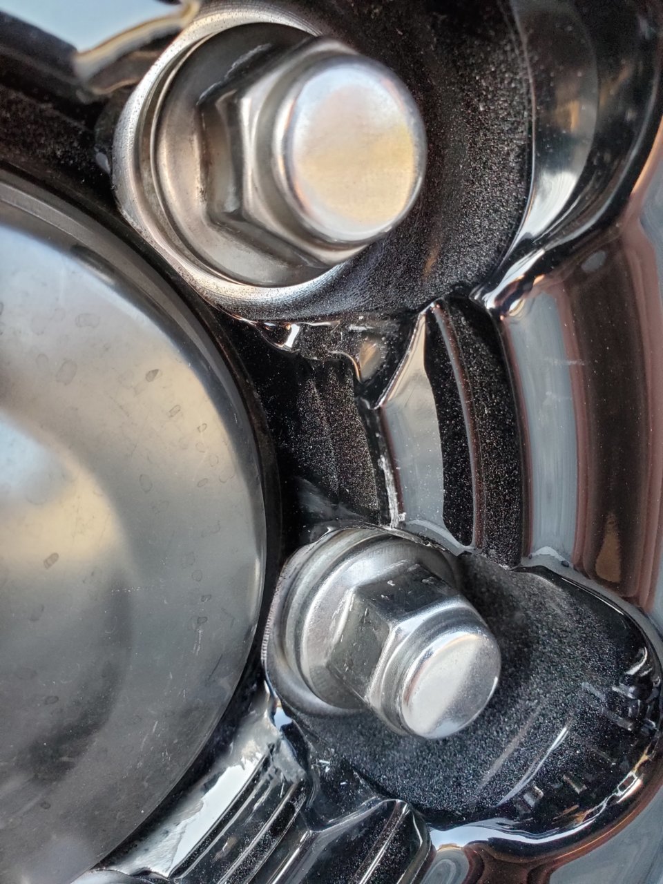

    Most likely from an pneumatic impact wrench. Time dictates that they need the speed of those tools to be efficient so I can’t argue against using them. BUT- if they are using them on painted or high-end rims/wheels- they should be using impact designed sockets with Delron/Nylon/HDPE sleeves on them. All high end auto shops use them for this specific purpose.

    That's what I thought as well, though there were some additional scratches when I took off the center cap where they click in, so maybe the machine they use to mount as well? IDK 20190407_081343.jpg

    Those other scratches are from the wheel balancer cones. Demand new rims. If they won’t do it, small claims court. I had this same issue about 6 years ago on my S2000 and ultimately the crappy Honda dealer paid me after I filed a claim in court. Got paid for the rims, mount and balance fees, and a few hundred bucks in legal fees it cost me to file.
    Don’t settle for less.

    A regular impact socket with a layer of duct tape around it and just barely folded over the leading edge works too....
    Whether they replace or fix them, as long as they look brand new...
