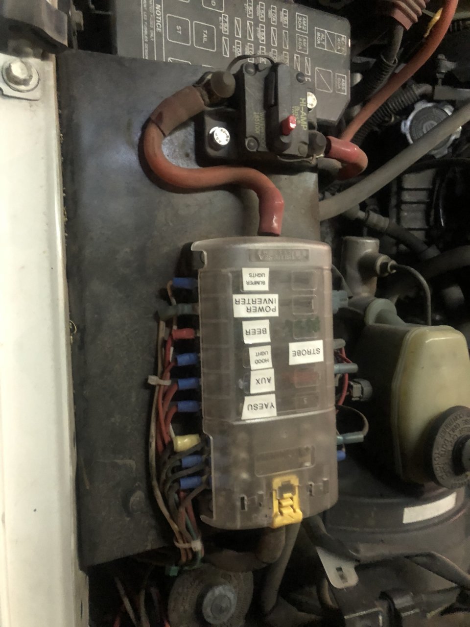

    Nice build, coming together. Liking the RF rear bumper, I have their sliders, good stuff for sure.

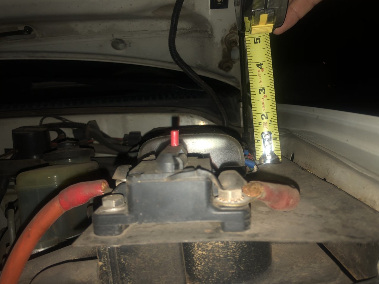

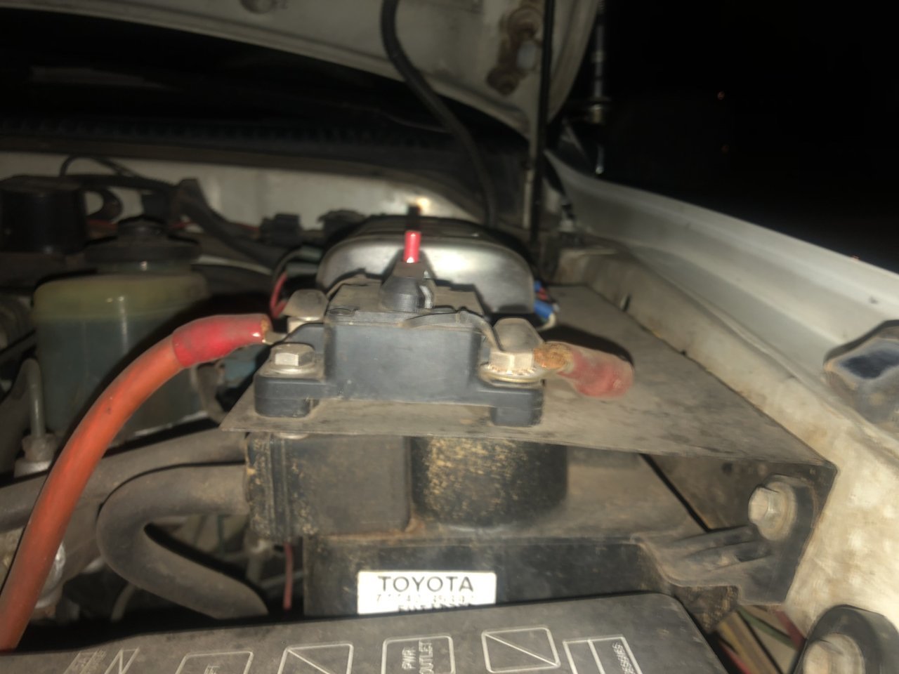

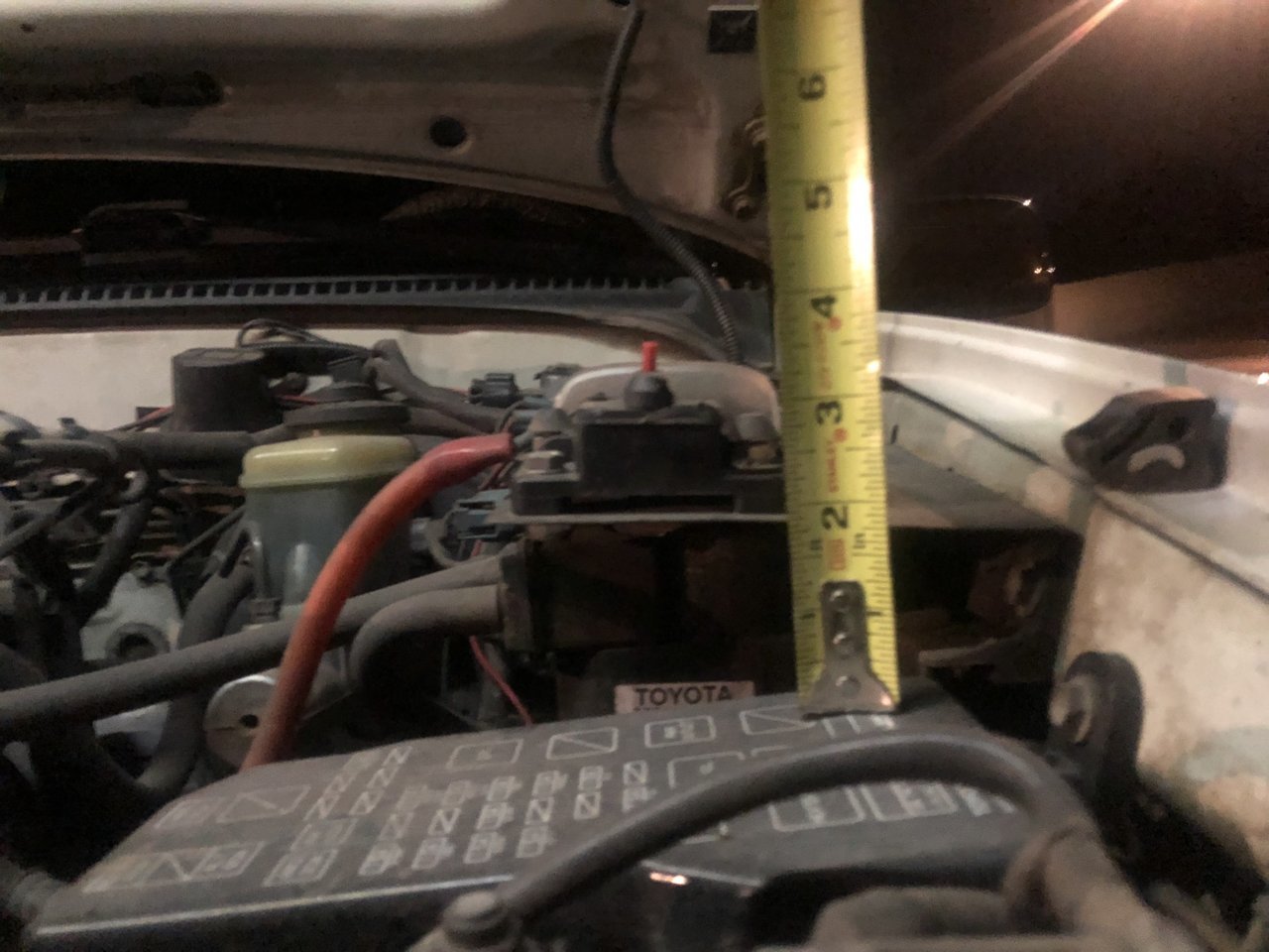

    I am looking at a Blue Sea aux fuse panel myself and was thinking about trying to locate it above that monster charcoal canister. Can you take a few photos of your setup? How much clearance do you have there? Thanks

    Thanks.
    Yeah, I can get a few pics later today. I'll wait for the sun to come up. There is just enough clearance for everything. When I added the hood shocks, there actually wasn't enough clearance. Had to do a little hammer modifications to make it work, but it works.

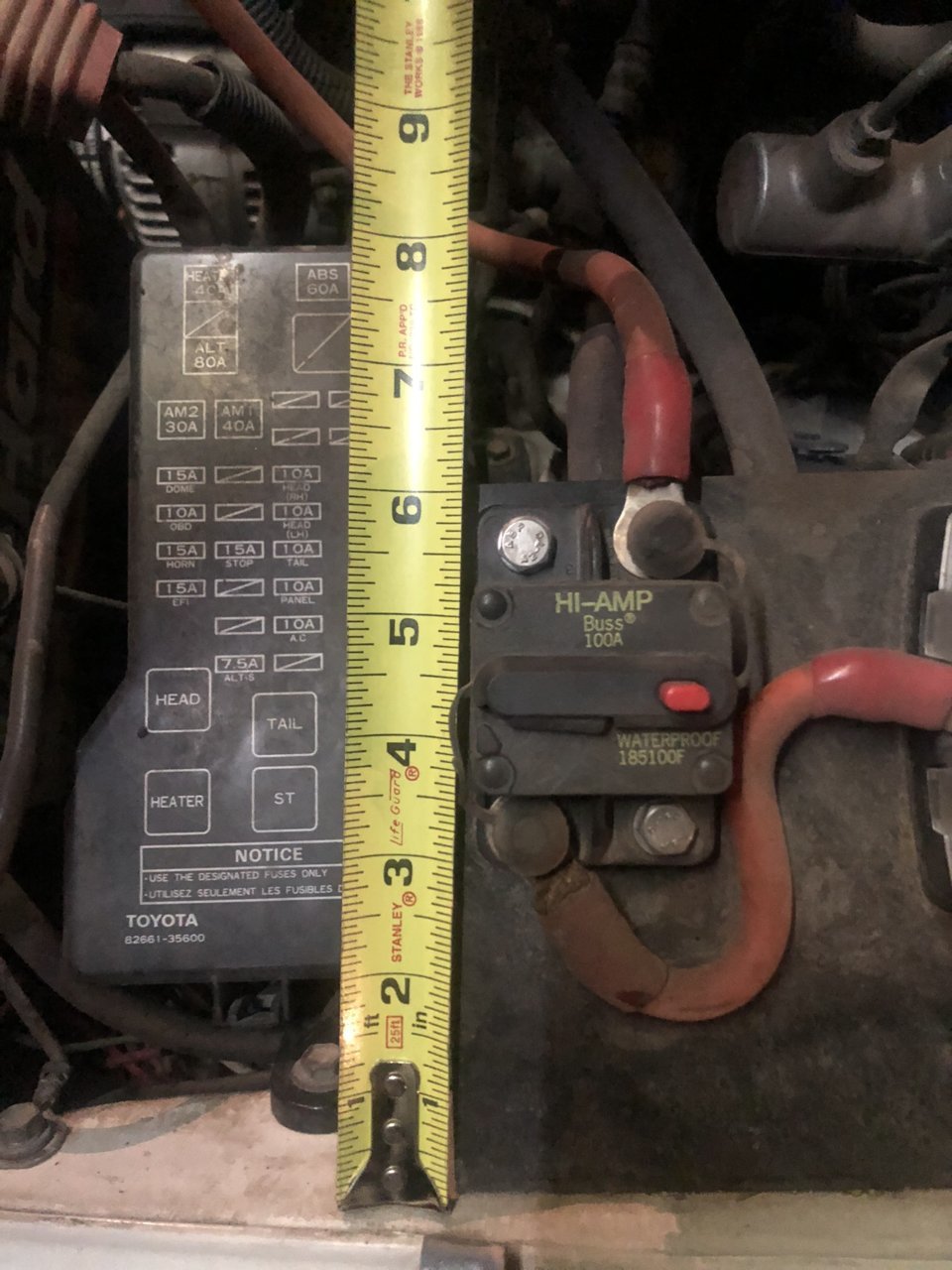

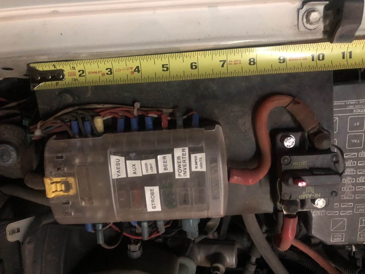

    Could you pull some dimensions as well? I had some written down before I left to catch a ship heading to Antarctica, but seem to have lost the paper. I'm hoping to find some scrap while I'm there and bend one up.

    Sure
    Thanks for the reminder, I’ll get this done this weekend.

    Hope these help.

    Awesome, those will work great, > 2 weeks out, 5 days to NZ
    Thanks a bunch.

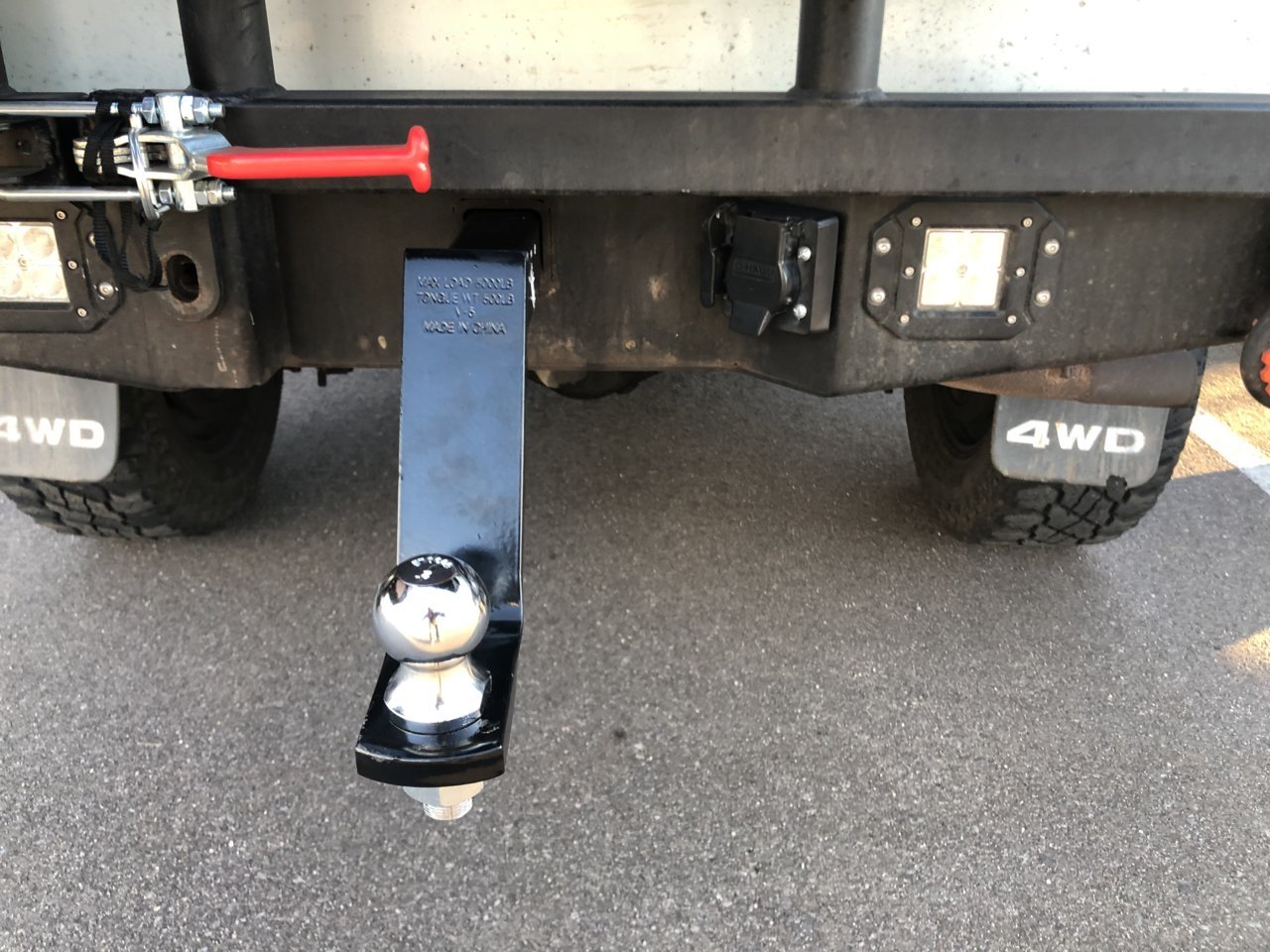

    I didn't get to do the short shifter today, but I did get to work on my truck. Since I got the plate bumper, I haven't had a chance... need... to reinstall the trailer wiring. Well, my wife is heading out of town in the Sequoia this weekend and signed me up to go pickup all the cookie boxes for the Girl Scout troop. So, I bought a 6" drop hitch, and rewired the plug.

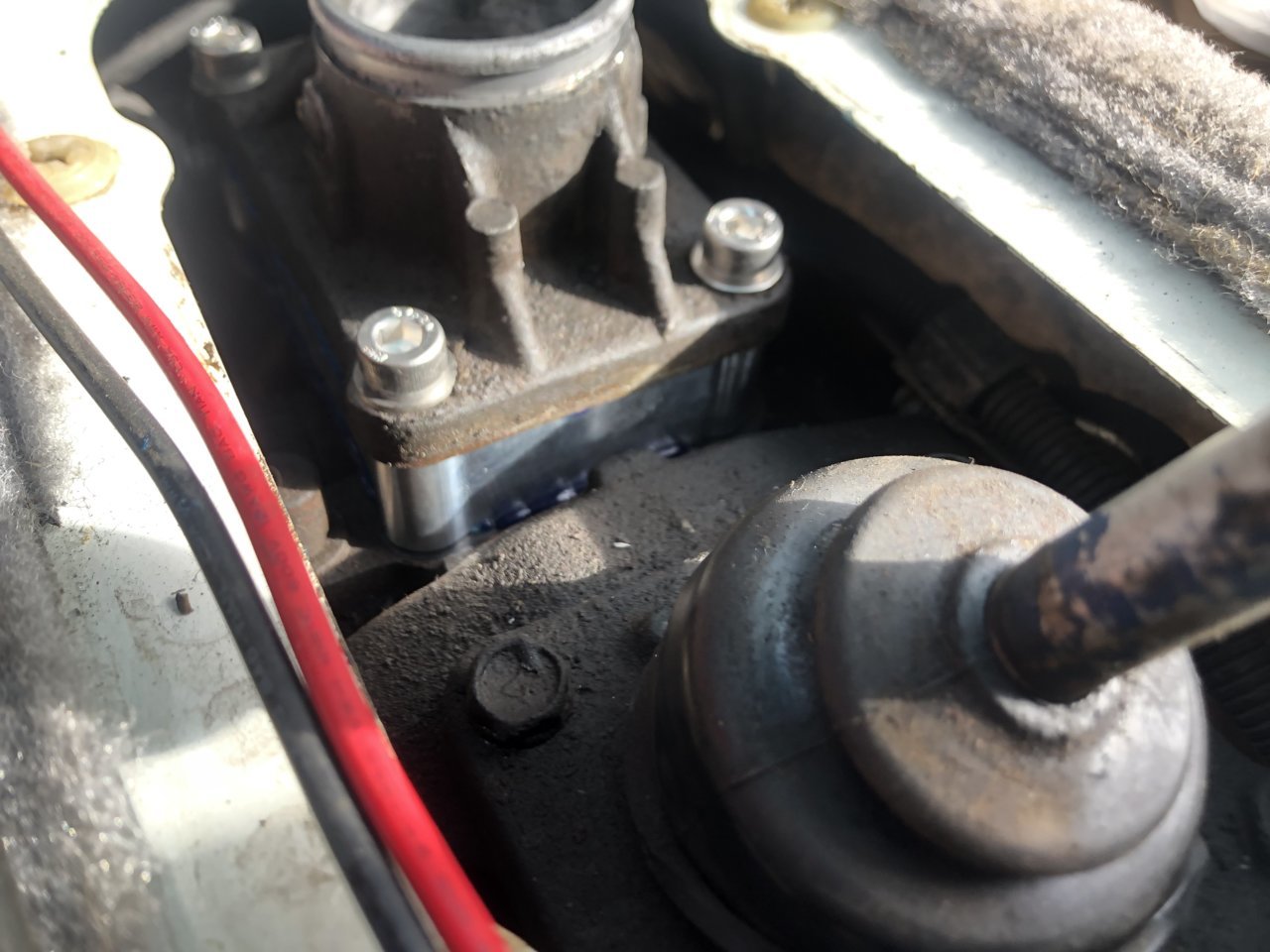

    I know Jacob from Colorado Springs.... I mean my anonymous Secret Santa will be happy to hear I finally installed my URD Short Shifter kit! I have wanted this for the 8 years I have had this truck, just haven't had time. Today, the wifey was mad at me, so I figured it was best to spend the day out in the garage. I have more work out there to do, I wonder if it is worth it to make her pissed at me so I can get it cleaned up..... hmmmmm nope!
    Easy install. Although I did need to go get a new shifter lever bushings. The old one was so hard it wasn't coming off without extreme assistance. I haven't changed it and I will bet the owners before me didn't either, so 310k miles on the original bushings isn't to bad. $15 for a new set was worth it. I only had time for a short test drive... I like it.

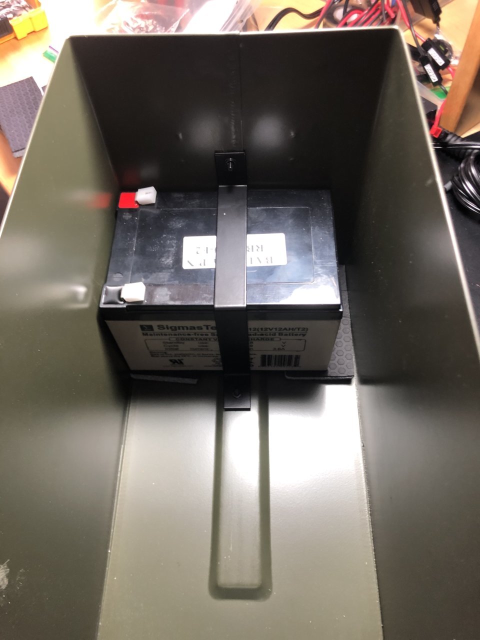

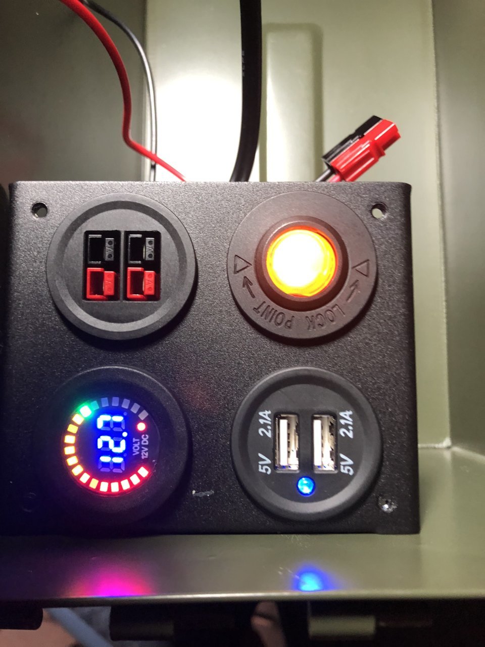

    Work asked me to have a portable ham radio, for monitoring events that have hams working it. I am a contractor, so tax deductible, I’ll take it. I decided to take this radio and build a “ham in a can” or go box.
    It will have a 12ah battery, usb plugs, power pole plugs, and be in an ammo can for quick grab-n-go.
    I have the main panel wired and installed (by install I mean the holes drilled and it mounted in place, everything has to be pulled out to mount anything else) and the battery mounted. Working on the antenna connection placement and radio placement.

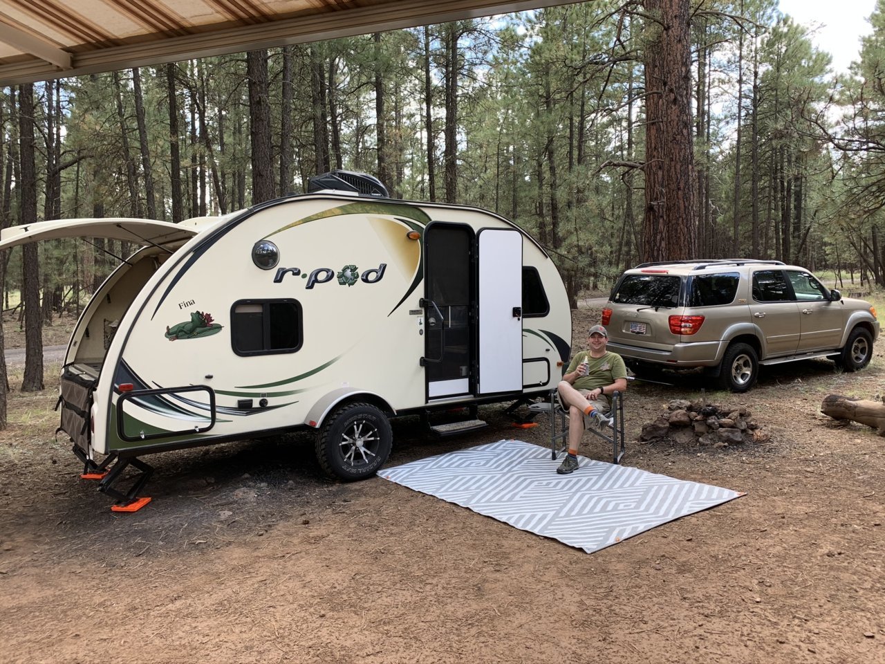

    The Sequoia got a new job, tow our mobile cabin. Picked up a 2011 R-Pod 182G.
    No more sleeping on the ground or cooking in the pouring rain.
