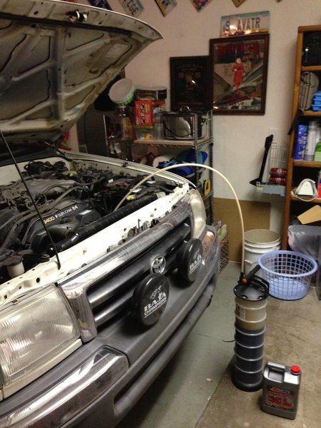

    Going through my old pictures on my phone trying to find the things I have done and not done a write up on. These won't be as detailed as some of the other posts (past or future). But they will help fill in the blanks from were I left off to where I am today.
    OIL Changes
    If you do not have a vacuum pump for changing your oil, you are crazy. They make changing your oil stupid easy. And clean! A lot of the high end car dealerships use them. I bought mine from West Marine for about $40. I think it holds 7 qrts. Pull the dip stick, put the tube in the dipstick and pump a dozen times or so. Then open a beer and wait for it to suck the oil out. This is how they change the oil on boat engines. The container holds they oil until I get to an auto parts store to recycle it.
