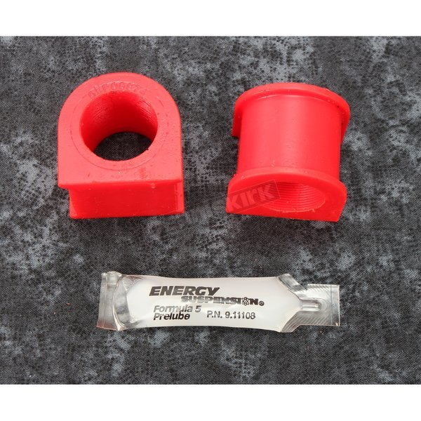

    I've heard almost the exact same sound coming from the two front sway bar bushings...
    even after using the silicone grease, which is what they say you have to use on the energy suspension ones......guess that bar in front has a lot of movement on those two bushings...
    In my case it went away after 3 or 4 hundred miles...
    And it was very noticeable at low speeds on rough roads...kinda pissed me off because I did everything as told to do...
    1000% certain it was those....because I usually do one thing at a time.....instead of trying to cram in a bunch of stuff at once.....lessons learned...
    may not be your case.....but reminds me I need to inspect those for wear....since I'm about a year out on those...

    I recently installed the same exact energy suspension sway bar bushings and greased them up really well. The darn chirp was there before and after the replacement.
    The chirp sounds like it’s coming most predominately from the steering column area or the front driver side wheel area. It’s really hard to pinpoint exactly though.
