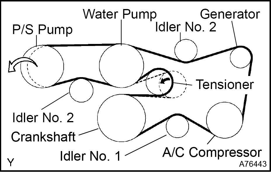

    Alright, not that. Did you 100% get the belt routing correct?

    Why is there an arrow on the power steering pump? Is that adjustable?

    No adjustment there. I think they are suggesting that to be the first place off / last place on when installing the belt.
