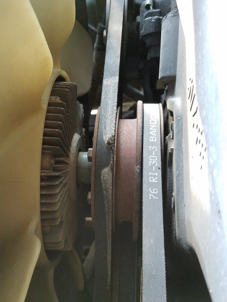

    The belts seems pretty tight, the alternator belt gets a 1/2in deflection which seems fine to me along with the power steering belt, but the power steering belt is disintegrating would that be the whining noise ? Like so

    I agree with this; it's what happened to me. It eventually turned into a high pitched screech. The ball bearings from the fan clutch literally fell out and part of the race was sticking out by the shaft. The screeching sound would come when first starting the truck then quickly die out.
