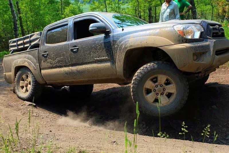

    Let me reintroduce you to my 2013 TRD Sport DCSB Taoma that I call Rue! 3 years ago I made an attempt at a built thread but it wasn't that good so today after some revamping here is the new build thread.
    Rue and I scoping out the trail we just climbed.

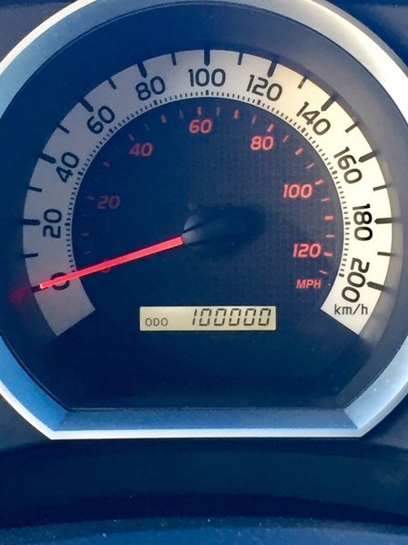

    Rolled over 100,000 Km of awesome adventures in this truck and couldn't be happier! Rue, on the other hand decided to celebrate by intermittently throwing a CEL for a coil pack malfunction.
    The code being tripped is PO356. I am going to move the coil pack on cylinder #6 to cylinder #1, if it throws code PO351 then I'll replace the coil. If the a new CEL isn't tripped then ghosts, if PO356 continues then its going to Toyota.
    Has anyone else had to replace their coil packs?
