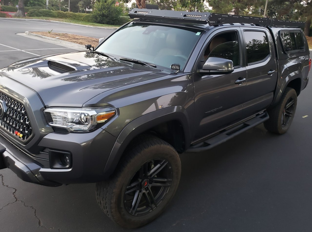

    I went to my dealer and they asked me to remove my roof rack and my camper shell to replace the light. Well, in order to do so, I have to remove my light on the roof rack too. So I declined the recall but not sure how bad this could be. Any thought about this?20210820_194116 (2).jpg

    I read the recall and that's why I was surprised to read the thread I cannot find. Fairly certain someone posted the procedure as well. And if there wasn't a leak, it looked they just performed the work from the back of the truck. I'll also admit that my memory is pretty bad, so there's that.
    I am also surprised that the dealer asked to remove the roof rack. I can't imagine why.
    Beginning to think I'll just opt out. Mine isn't leaking. And it hasn't leaked.

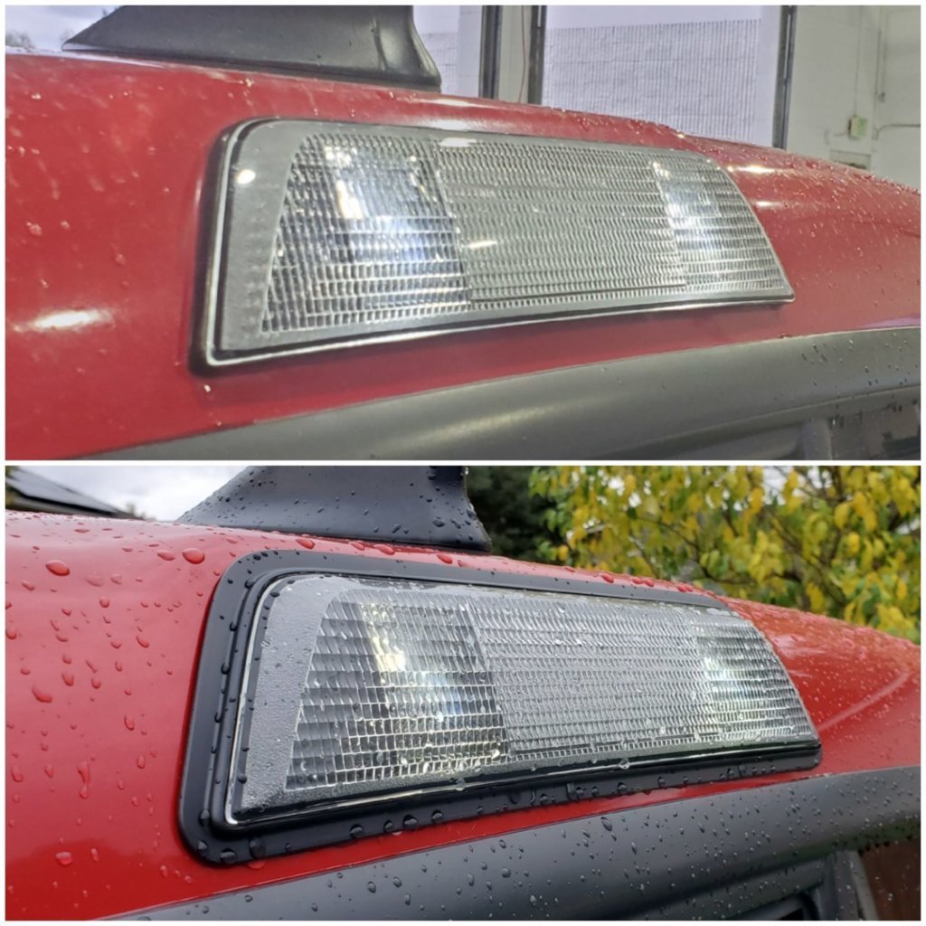

    If you don’t have any leaking they will run a bead of caulk and install an external bezel to make sure it won’t leak. Be good to get it done. I want mine done but there’s no campaign for Canadian vehicles. Dealers in Canada won’t do it and you can’t order the parts here.
    You can do it yourself. Order the repair kit at your dealer (00948-CHMSL) and it will look like this when you’re done:

    The trim makes it looks better too.

    Thanks for sending these pictures! I was going to ask for one.
