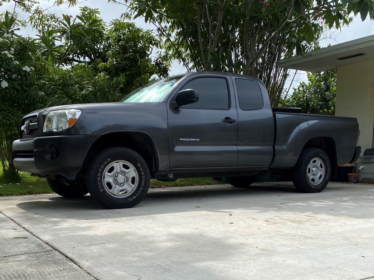

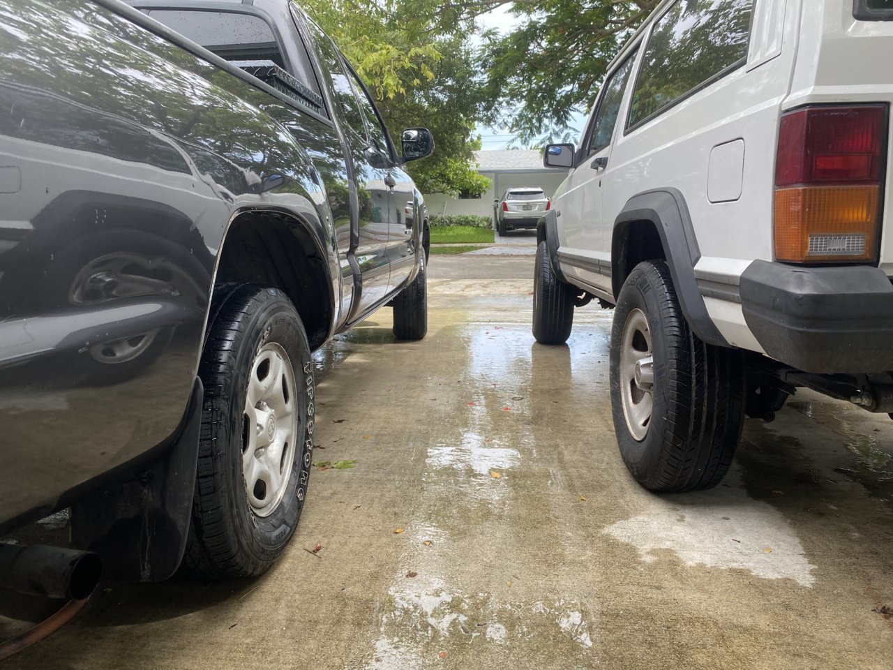

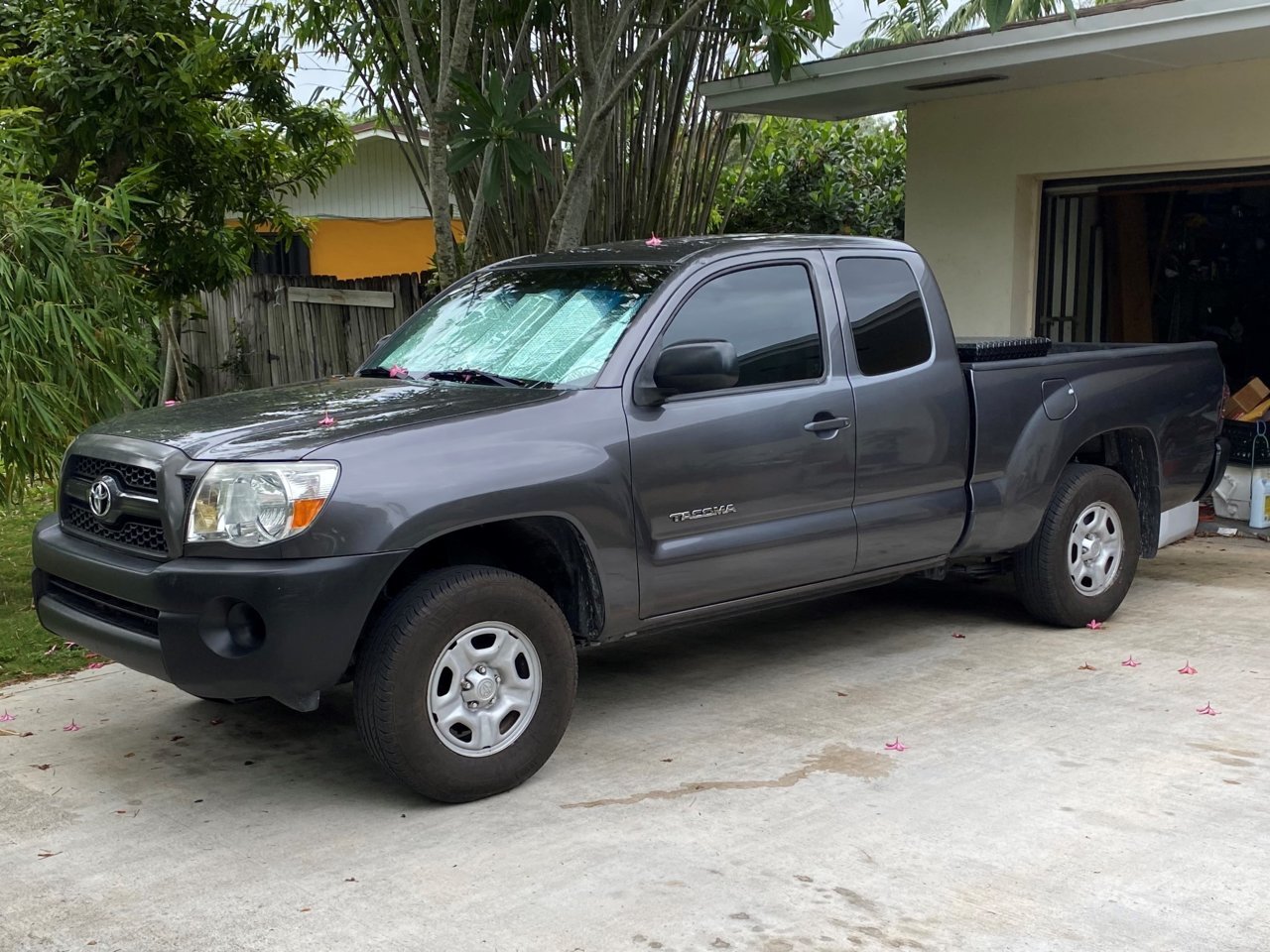

    IMG_6897.jpg IMG_6966.jpg IMG_6949.jpg 2011 Access Cab, 4 cyl. 5 Speed. with Fat Bob Level.
    Just swapped the 235/75/15 tires on my Cherokee with the 235/70/15 that were on my Tacoma.
    Seems to be a little taller. Haven't driven it much or calculated mpg difference.
    Will probably stay with this set up once tires wear out

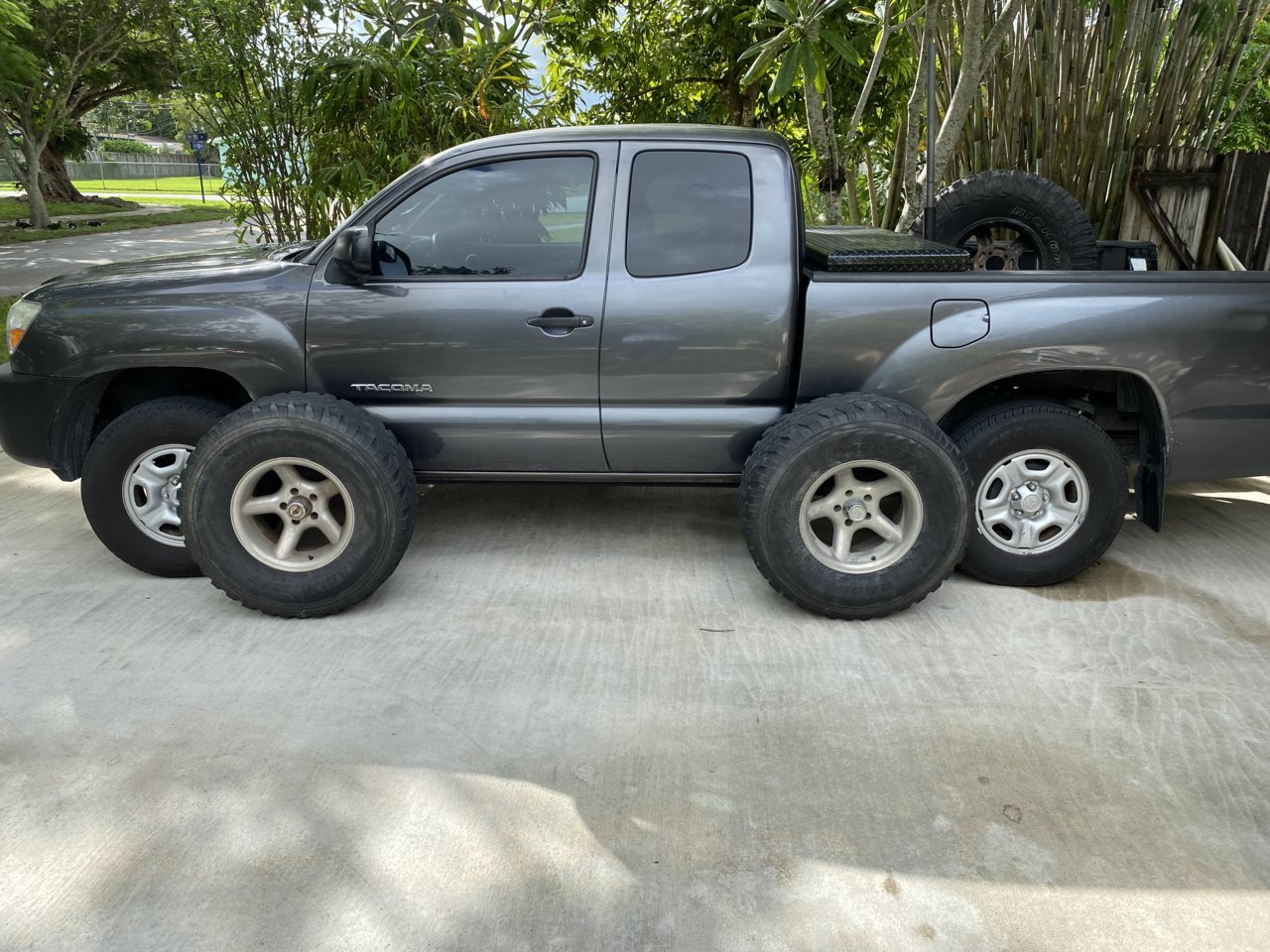

    [​IMG] Just bought some old Enkie rims (5-$200)that came with bald 33X12.5 tires. Plan was to see how it looked/rode with those tires then remove tires and clean up the rims and put some 31X10 tires on them down the road when present tires wear out. I did the black box mod, tried to mount the rim but the lug nuts (M12X1.5)were buried and I couldn't get the socket around them to tighten them. Not sure how to attach lugs - longer studs? Extended lug IMG_7383[1].jpg Here are the 33's on it. Surprise, it rubbed badly. Took tires off, cleaned rims somewhat, bought center rings and pressure sensors. Waiting for current tires to wear out more and then going to go with 31.10 s. Truck has a Fat Bob's leveling kit.

    I’m sure either option would work, longer studs might be a pain to do though
