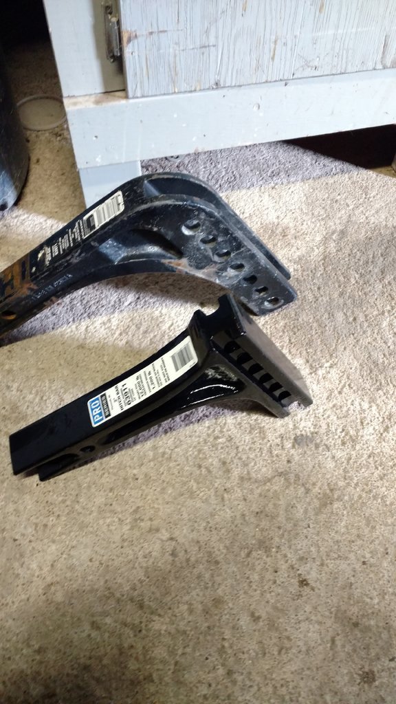

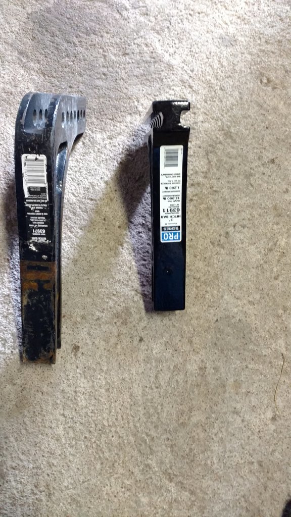

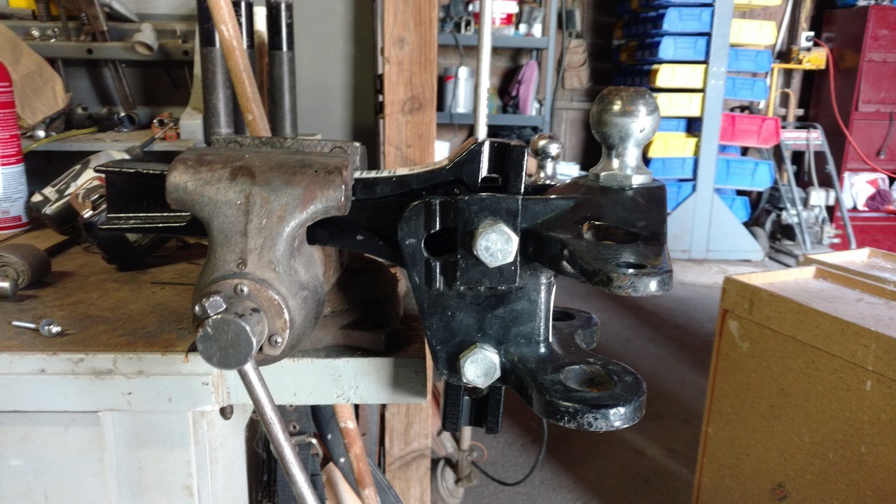

    Pro series, I have one hitch bar for my Tacoma and one for my 3/4 ton Silverado. You can enter change the head kit both hitch bars. The smaller hitch bar is good for 10k and the larger one is good for 12k. That set up is good for a lifetime for most. Some may call it overkill for what your towing but if you buy a good WD hitch you can use it for any trailer set up. I use mine on a multiple MC trailer, 4k Camper and a 4800 lb boat. The smaller hitch bar is what you will need for your truck, the pro series site will confirm it. I always use a WD hitch anytime I get close to 50percent of the legal tow weight for the vehicle just for the additional braking power, handling and ride stabilization. Hope some of this helps I'm sure many will tell you you don't need it or a brake controller but if you have ever had a trailer go squirrelly or need to stop fast it's worth the price.
