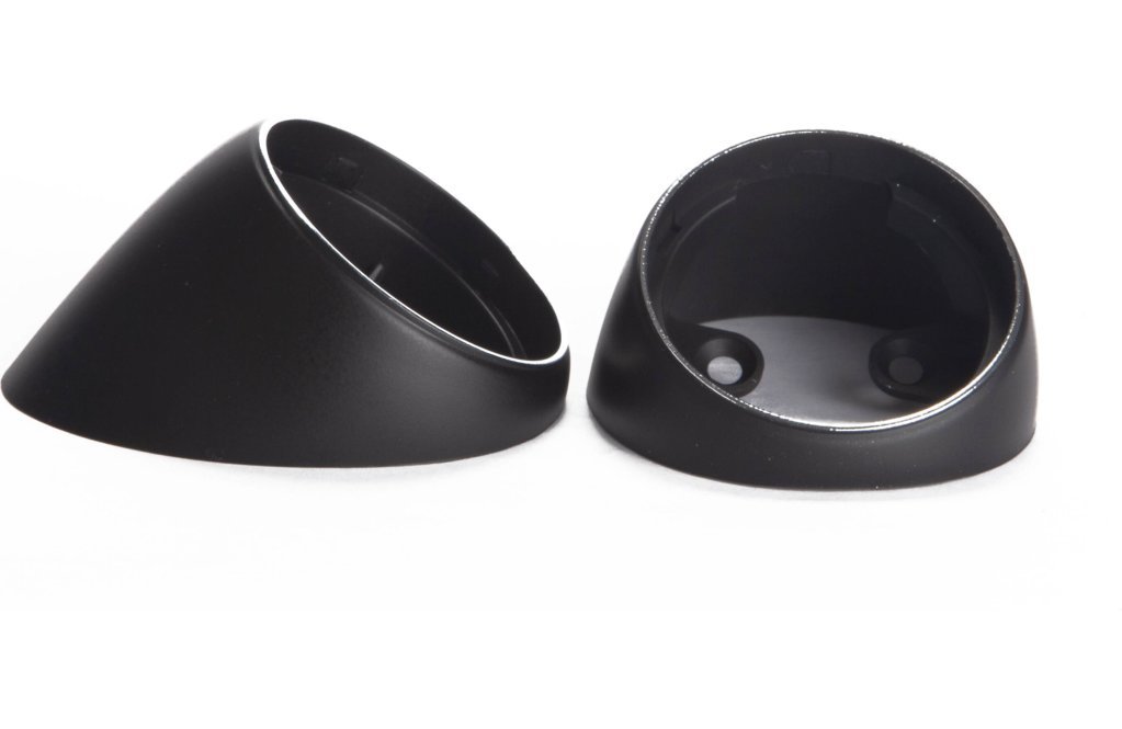

    I've been playing with the EQ on the Kenwood DMX958XR, I can get the system to play better but the tweeters are struggling. Having them point at the windshield isn't helping. If I put my microphone right at the tweeter, the audio band just spikes up when playing pink noise yet having the mic where my head would be, gives me a downward sloping graph on audiotools.
    I'm thinking tweeter orientation is quite important. The pods supplied by morel for the mt300,350 and 450 tweeters are really nice. I figure that with those pods, I could install the tweeter in the A pillar or the sail panel and point the tweeter in a better direction.
    I'm not having luck locating those pods...

    Yes, reflections can boost or reduce different frequencies, or be used to alter the sound stage 'width'.
    Personally, I prefer indirect tweeters for the more expansive sound stage, but it tend to emphasize tweeter attributes by a bit, good or bad.
    Which pods are you looking for?

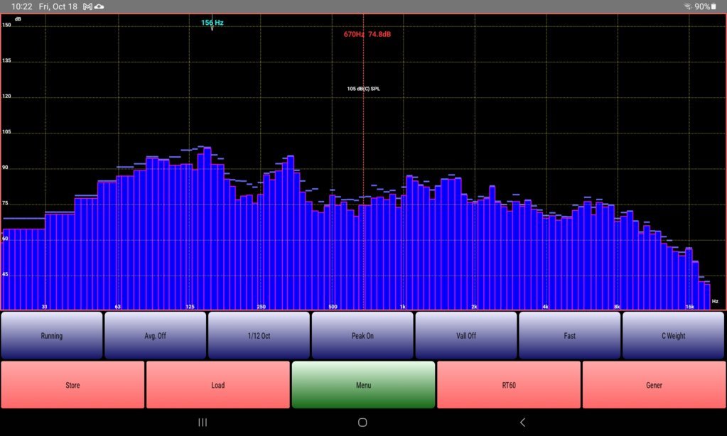

    I'll try to capture a screenshot of what pink noise looks like from the drivers seat on the Audiotool app. From what I understand, the woofer and tweeter combos usually need to be relatively close to each other in order for the supplied crossover to be optimal. Right now the DB for any frequency above 8000 are quite below what a flat curve would look like. Two things come to mind: One: The tweeter curve is decent when the mike is right next to it. Two: When the mic is next to driver headrest the upper frequencies are quite low so the upper frequencies aren't making it to the mic.

    Looking at the Morel line of tweeters, I really like the mounts they offer with the MT300,350,450 series. It would improve alignment of the tweeters to the occupants.g210MT300-F.jpg

    Heres the sound with the mic at drivers headrest,Screenshot_20241018_102238_AudioTool.jpg

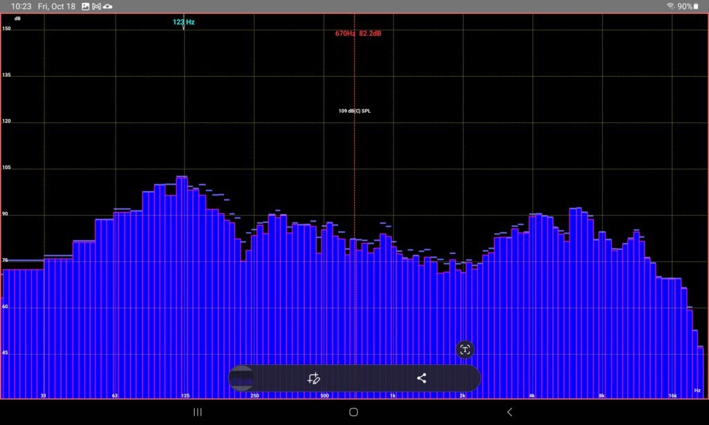

    Here is with pink noise playing but mic at 1 inch from tweeter.Screenshot_20241018_102332_AudioTool.jpg

    I dunno, it doesn't look that far off. The general tweeter curve is about the same in both, just a different amplitude, that's expected with the change in distance.
    I would still suggest a different tweeter, not a change in positioning.
